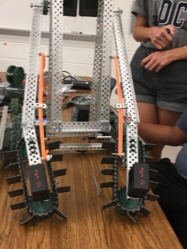

Here is the robot. We gave to fix a few things but other than that that’s it.

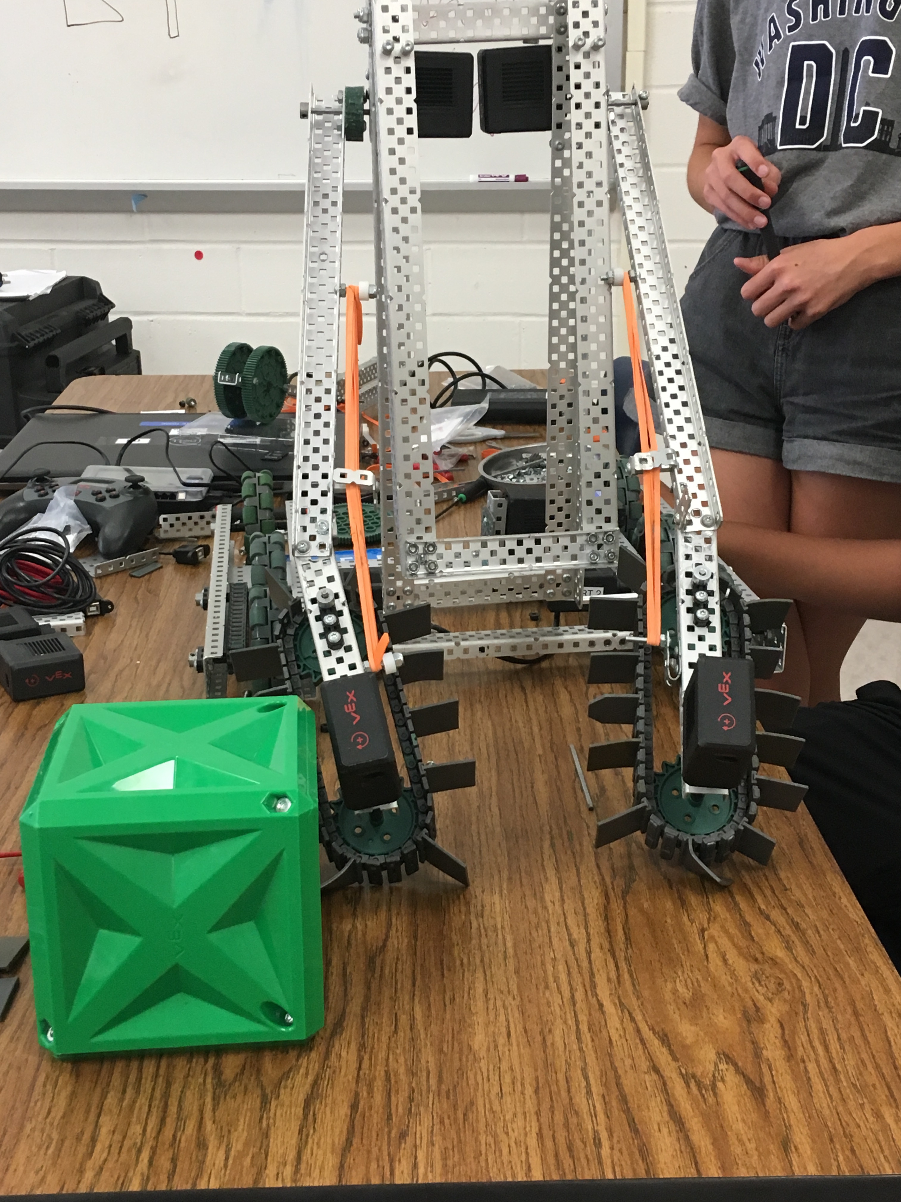

Can you mark the intake issues/put a cube for size reference
the cube works well with the intake it fits perfectly fine . but up where the intake connects to the lift motor (i dont think u can see it on this pic but its the best one i have) , there are some torque issues and it is a little heavy at the end because of the motors being at the very end
Here it is with the cube next to it
You could probably use come bars to channel the cubes in a direction that wont interfere, then the best way to add weight to balance things out would be to use steel c-channels where possible. Hope it helps, I am no good with pictures of robots.

So it looks like your lift is powered by two motors. What motor cartridge are you using? You might want to gear up the arms to increase the torque too.
I believe that on the lift we used the red motors, 36:1, but it may be 18:1 motors. I’m 99% sure it is the 36:1 motors. And thank you for the tip!
Yes, the red cartridges are the torque ones. I would suggest gearing the arm with a 12 tooth metal pinion and a 84 tooth high strength gear.
1:7 gear ratio

And one thing is that I don’t think I see is flat berings on your axle pivot points. You should really put some in, they will prevent holes from emerging in your metal where the axle is. And it will also improve your arm’s stability.
