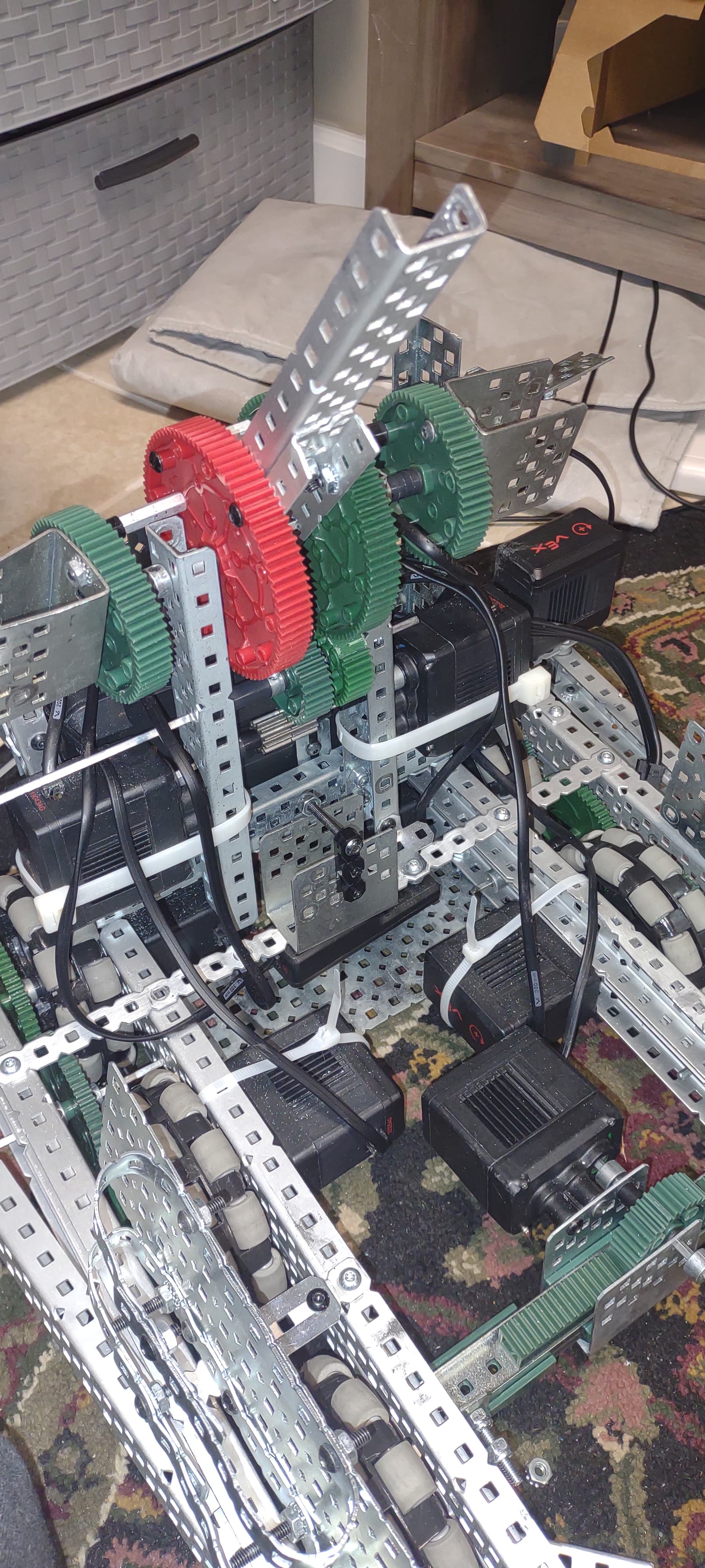

So I have been working on our catapult this winter break and I have added stoppers for it and figured out the right amount of rubber bands, but now I’m stuck on the bucket. I really don’t know what type to do after testing a couple different ones. Any ideas?

None of them really worked, I am thinking the angle that the catapult stops at is a factor in why it isn’t shooting far. Thoughts?

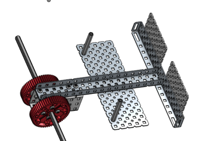

  1. It’s really cursed, we’re replacing it, but here was our cata bucket:
  2. For your cata range, either (1) use more bands, (2) use a longer cata arm to impart more speed into the triball (yes, the terminology is wrong, but you get the idea), or (3) change up the angle on your catapult (not too vertical, or else it’ll angle the triball downwards; not too shallow, or else it’ll aim high but not far)
What are you replacing it with? If I were to go with that design wouldn’t the triball pretty much be going straight down?

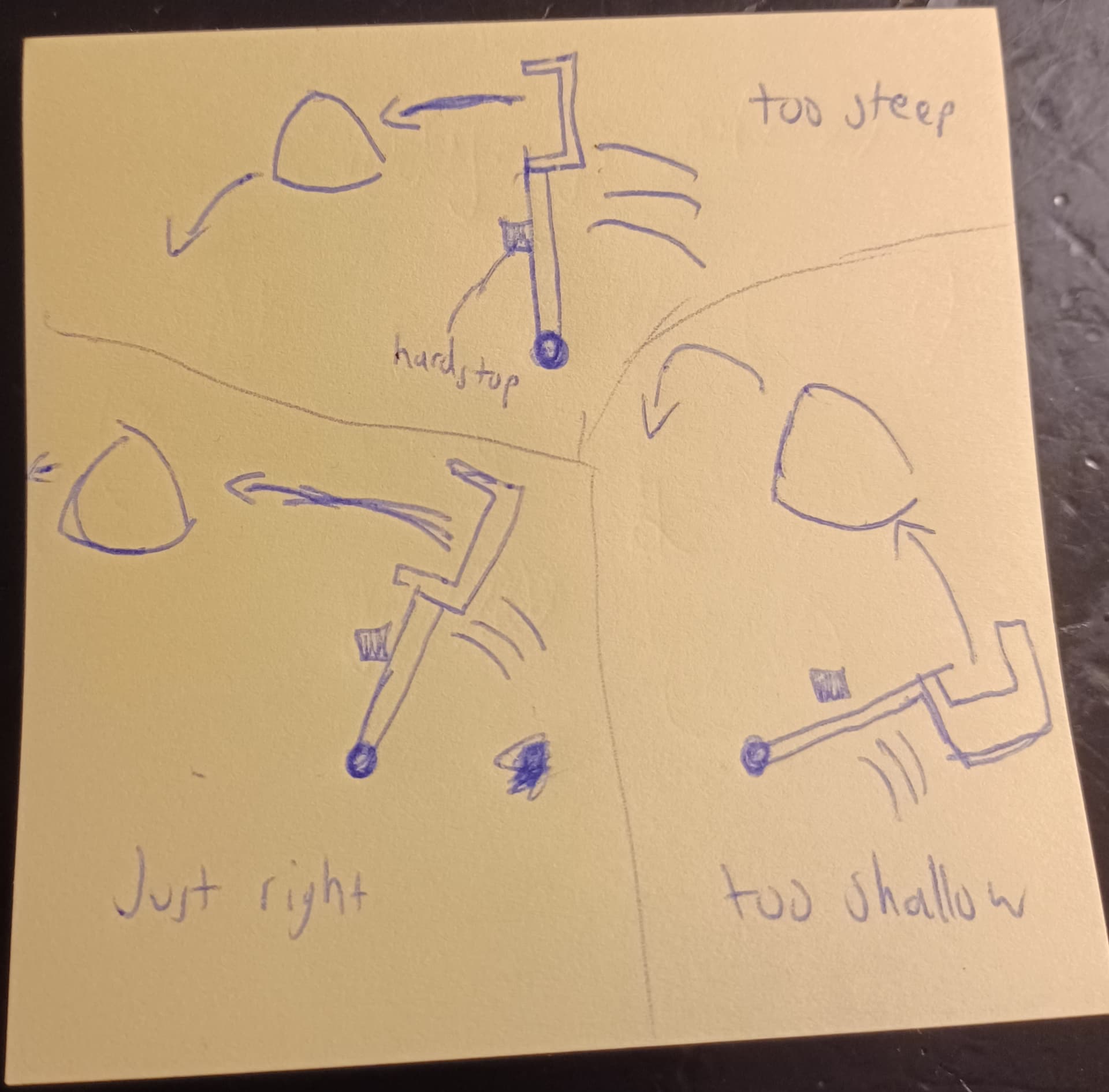

Sorry for the janky sketch, but here is how cata angles work;
Thank you for the sketch, where do you think my angle would fall under? I made a temporary bucket (or holder) and the triball needs to go a little farther. I can’t add more rubber bands because of torque reasons and I can’t make the arm bigger because of space (I am adding a blocker today so if it’s any bigger it will hit the blocker)

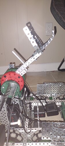

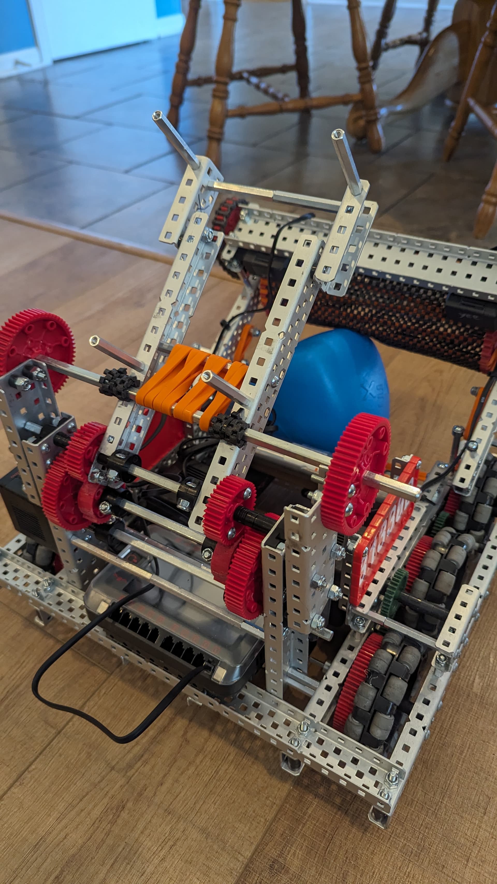

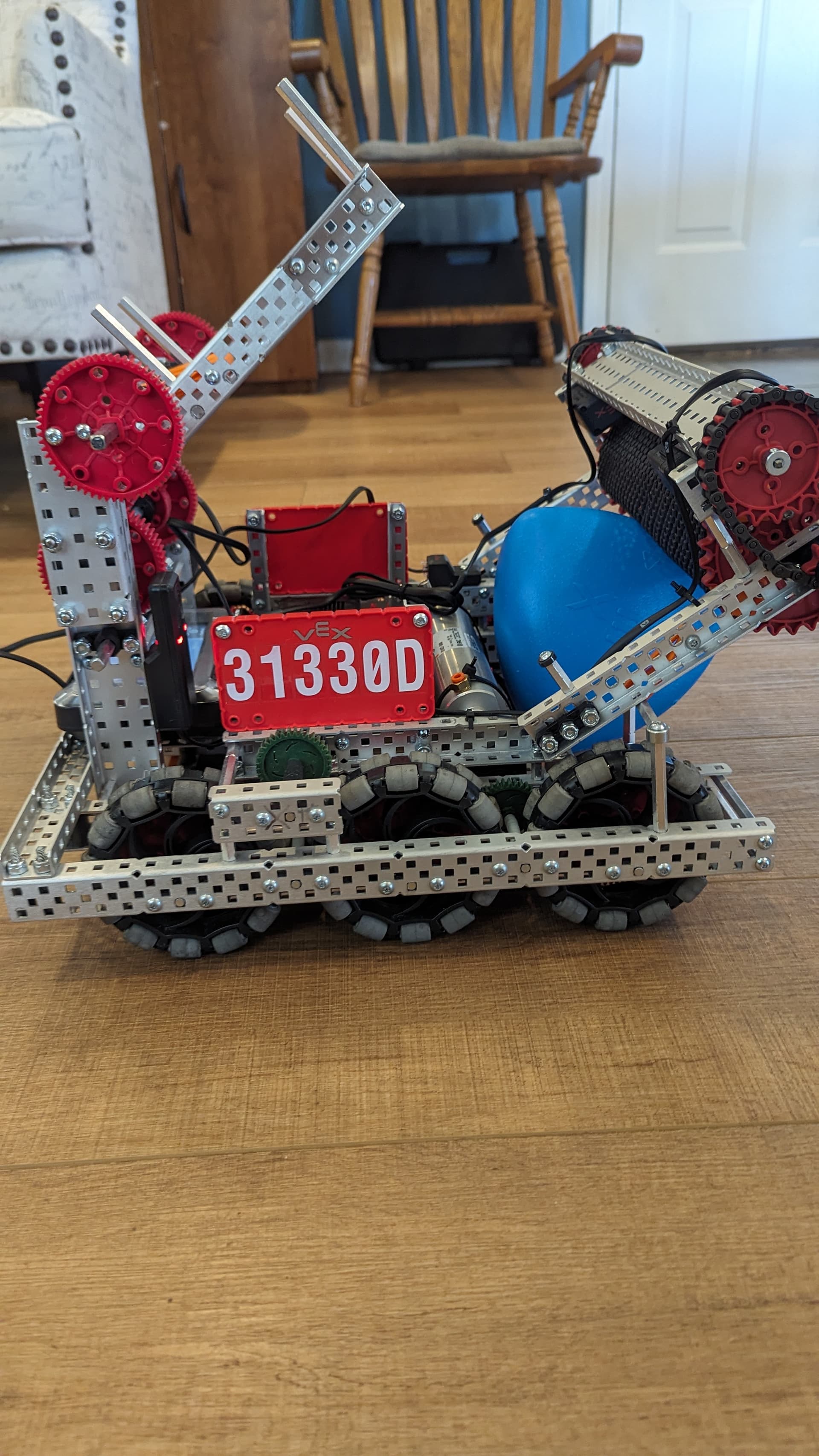

That looks like a good angle. Make sure that your bucket is rigid. Those bent plates you are using look a little flimsy. I use standoffs and they work great. My shots are very consistent and easy to tune. I will include pictures of my catapult.
I hope this helps!
Thank you for the input! I will add standoffs ASAP

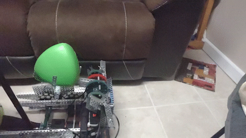

VID_20231227_134759026_AdobeExpress

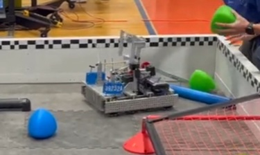

Here is a gif of it shooting
Thanks for the gif! That is a good angle for shooting.
However, I looked closer at one of your images, and it seems you are running a blue 600 rpm motor 36:84 for a 257 rpm cata. That is really fast, and probably too fast. I would recommend changing the cartridge to a green 200 rpm (which is about 86 rpm in the end) and doubling the band number (seeing as those motors are hot swap this should be a quick fix). 86 is towards the low end of the average, but it is quite competitive especially since it can hold quite a few bands.
I was thinking about changing the motors too, I wish there was a way to make it shoot farther without losing speed. I’m also using 2 blue motors for the cata btw (Not sure if you saw). And the gear ratio is a 12 to a 36 to a 84 (I’m not good with gear ratios so it could be exactly what you said) Is there any other way to make it shoot farther? The only other way that I can think of with keeping this current configuration is by making the arm longer.
Ohh 12:84 gear ratio then. That should be able to hold about 5 or 6 bands at least.
The last thing I can think of is shave off less teeth on the slipgear so there is more of a retraction (and hence more time to accelerate).
For motor purposes, use a ratchet on your cata. This takes a lot of stress off the motors and can allow for a couple of additional bands.
Are you sure it can’t hold more bands? You can add another band mount closer to the cata so the additional bands don’t add too much stress to the motors.

A ratchet only allows the gears to spin in one direction. By doing so, it prevents the cata from backdriving the motors and takes the stress of holding the cata off of the motors
Here are a few examples:
