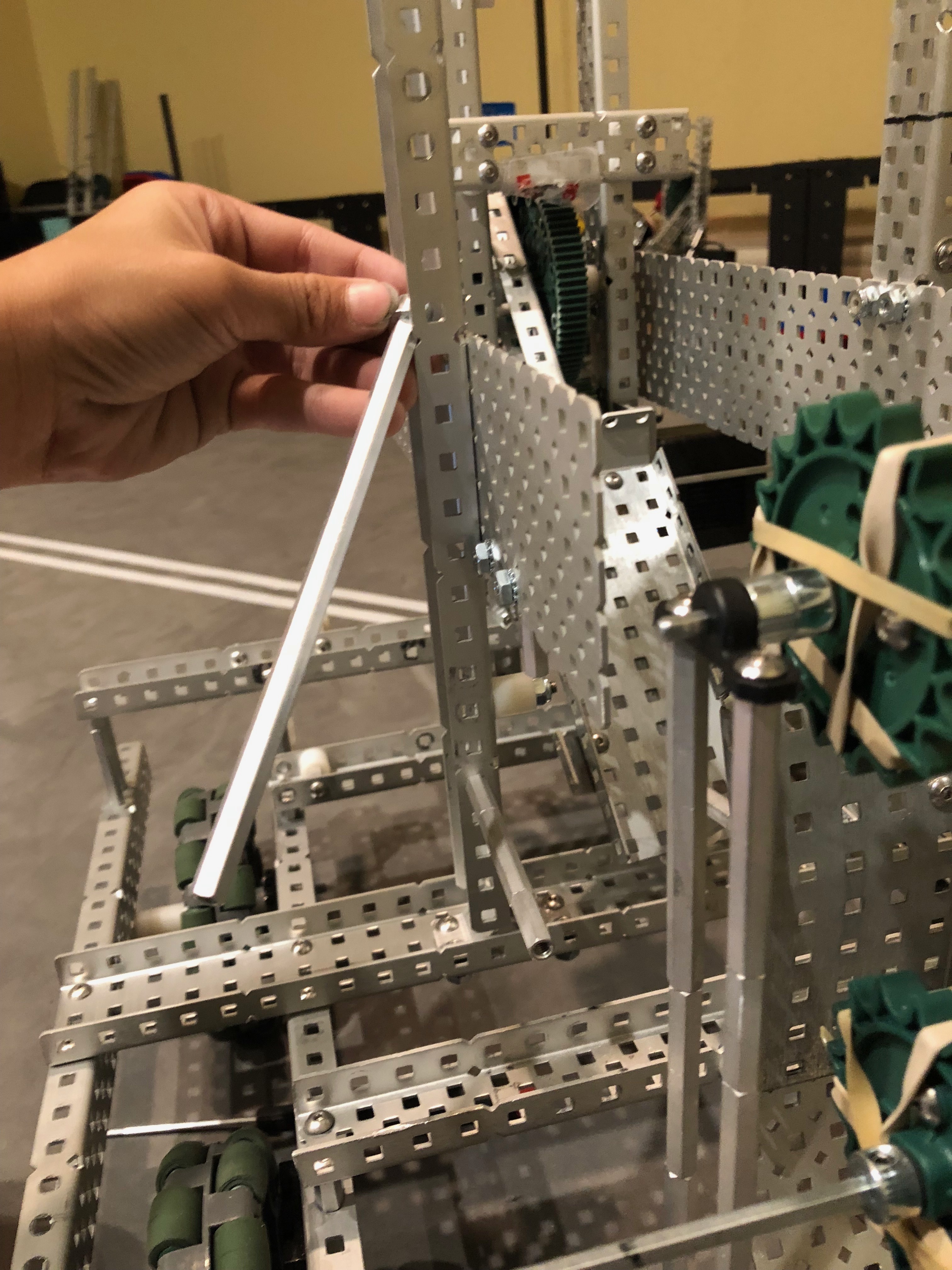

#2
I don’t know exactly what you mean from the photo but I am assuming you mean a coupler. It would connect standoffs together or to those small metal shaft collars. Here is a link to purchase some(I usually used the 1/2 inch FYI):

I’m assuming that’s a shaft collar on the end of that standoff, and you’re trying to attach it to the bar in that orientation. I suppose you could put a screw through the hole in the corner of the c-channel into the hold in the shaft collar (yes, it fits), but honestly, I would just attach it parallel to the beam. It’ll be a much stronger and less sketchy connection.
#5
I mean like attach the standoff diagonally against the c channel so the ends aren’t parallel to each other

I think he’s trying to attach it diagonally as in facing away from the c-channel.
#9
Yeah I am
but thx anyway

Never mind i can just put two shaft collars together and attach it at an angle so that the ends aren’t parallel (I know I make no sense but oh well) Merry Christmas Yall!

There are a couple of examples in the attached image from Starstruck.
Basically, you use two lock collars together as a universal mount (can rotate in any direction). The standoff attaches via a standoff coupler to one of the shaft collars, and the other shaft collar is attached to the frame by a screw. A screw and nut are then used to fix the two lock collars to each other.
