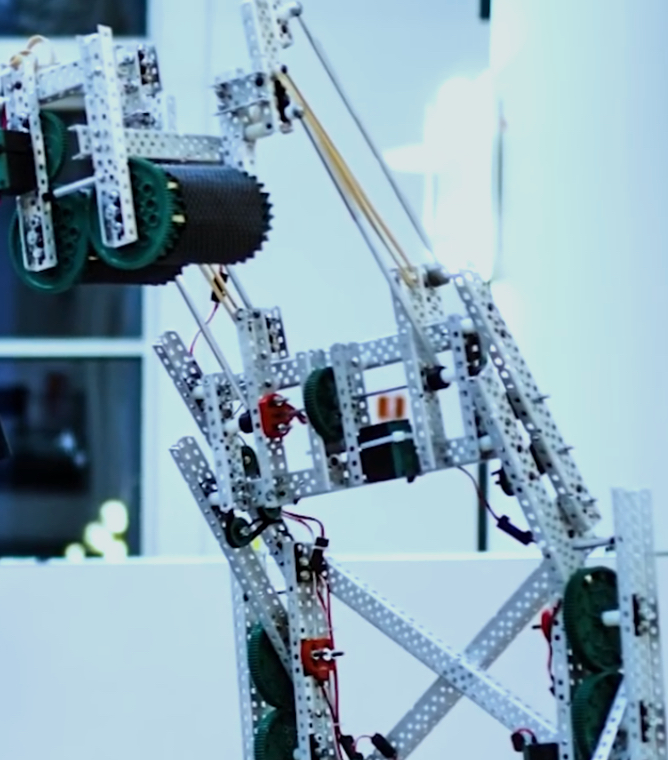

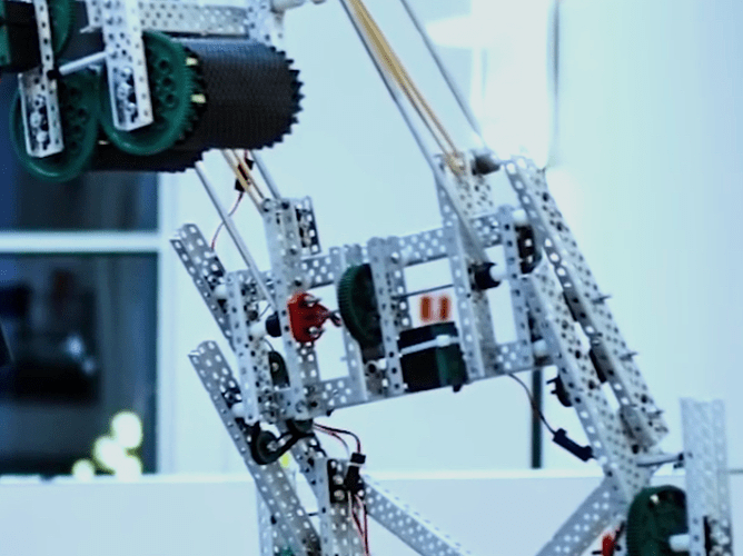

So we are still redesigning our robot, and we’re kinda down to the wire as we only have till Jan. 20 to get it working. We are designing something like the last video of 1961X or 6842Z. (PigPen) What i mean by this, is that we are using the same concept for an internal stacker as pig pen called it. We are completely unsure how to do this, and kind of need some help. We think we have the general concept down, but a second opinion would be nice. To show you what kind of stacker we mean, I have 6842z’s internal stacker below. No, I am not copying, i just have the same general design in mind

I need help figuring out how to do the internal stacker portion of the lift, and how to mount it on to my robot. I have a full DR4B built, and the top c-channel of the 4 bar is about 15 holes long. I am currently trying out the internal stacker design by using 3 hole to mount the internal stacker to, and then using the 3 hole to hook the two bars on either side of the top 4 bar together. I can post pictures tomorrow if you need, as I dont currently have my robot with me, and I did a horrible job of explaining. Thanks for responding

It’s how to fully construct the internal stacker in a way that works on the robot and can fit a motor plus A couple gears

315X’s reveal could help you a lot.
Here you can see how they mounted the internal stacking motor without it getting in the way of cones.
Ditto
Conviently, I was building my manipulator (internal stacker extension) yesterday and have a good idea of an easy way to build one. Mounting components should be all mounted on to a backboard with a gear box in the center of the backboard. I don’t have and pictures, but I have a picture of 9065C that’ll be helpful.
