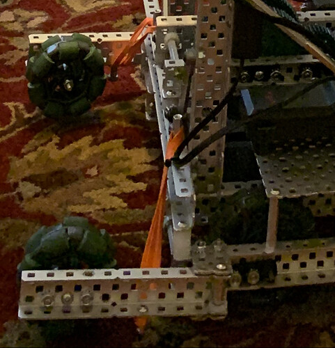

so we have antitips on the back to prevent us from tipping, but when we get 9 cubes on our robot begins to rock back and forth when we go backwards so we can only drive really slowly. We were looking for a way to make driving smoother. We already added some steel plates to the front as a counterweight. image
Does anybody know how to help fix this problem

I noticed that the rubber bands are lifting the bars off the ground. Try rubber banding the anti tips so they are forced down instead of up. this should help little and will keep the bars on the ground. or add a mechanical stopper above the bars so that they cannot bend upwards.

well something probably added to your chassis that prevents the c channel on the bars from bending upward. From the picture I would suggest something extending from the back brace so that when the anti tip bar flips out the stopper is just above the c channel on the bar. kind of like a lock of sorts but only for one direction.
You could always make them longer, that would also help some. You should also make sure your wheels contact the ground as you drive.
How heavy is your bot currently? You don’t want to add to much weight if your already on the heavy side. You could also make the wheelie bars a little longer, that could help.

an easy way to get a good anti-tip imo is to use the vex sliders with the slides that stick inside the rails. It took me a few minutes to make a slider anti-tip that works for 10-11 cubes.
The antitips seem to be attached to the chassis by metal plates, which bend easily. Try using c channels, better if theyre steel. Robot rearrangement could also change the center of gravity.

My motors are geared so I have space to move the back ones a little forward. I switched to c-channels and it’s slightly better. The robot isn’t very heavy either so I might add some metal plates.
