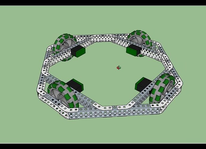

sorry i didn’t realize that it was called holonomic drive we called holonomic drive o-drive because it was easier to say
@Nick_S Do you want to control your drive with the joysticks or with the button pad? You have a really terrifying amalgamation of the two, and neither are setup in a way that works well. A good start would probably be to choose one or the other.
X-Drive or Holonomic X-Drive is probably the best way to refer to this drive system. Holonomic is a pretty general term which applies to Mecanum drives as well as a couple of others.

to clear up any confusion this is what im talking about
First, be careful with () v. ]. You’re not consistent.
It looks like you want joystick control. Delete all those motor controls. Make four lines, each as roughly
motor[one_motor]=vexRT(Ch#)+vexRT(Ch#)+vexRT(Ch#)
Those could be + or -, depending on the axis.

I really enjoyed working out the exact combination of plus and minus to get where i wanted. It was a fun thing to figure out experimentally.
We had a loop, and inside four motor commands set equal to the sum of the three joystick channels we were going to use. Add in a multiplier for each joystick. For each one, set the one channel you are interested in to a multiplier of 1, and then the other two to multipliers of zero.
Loop{
Motor(FL) = (0 * LV) + (0 * LH) + (1 * RH)
Motor(BL) = (0 * LV) + (0 * LH) + (1 * RH)
Motor(FR) = (0 * LV) + (0 * LH) + (1 * RH)
Motor(BR) = (0 * LV) + (0 * LH) + (1 * RH)
Here i used LV as Left Vertical, RH as Right Horizontal, etc.
If you know what you want each joystick to do, debug that joystick one motor at a time (change the multiplier to -1 as necessary. Once you do all three joysticks, it will be ready to go.
