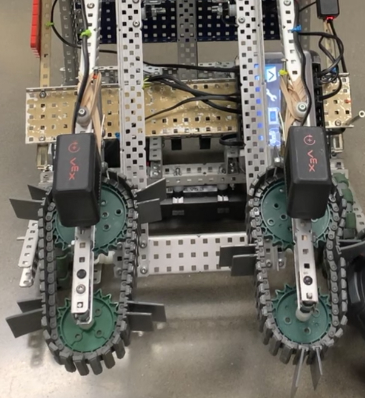

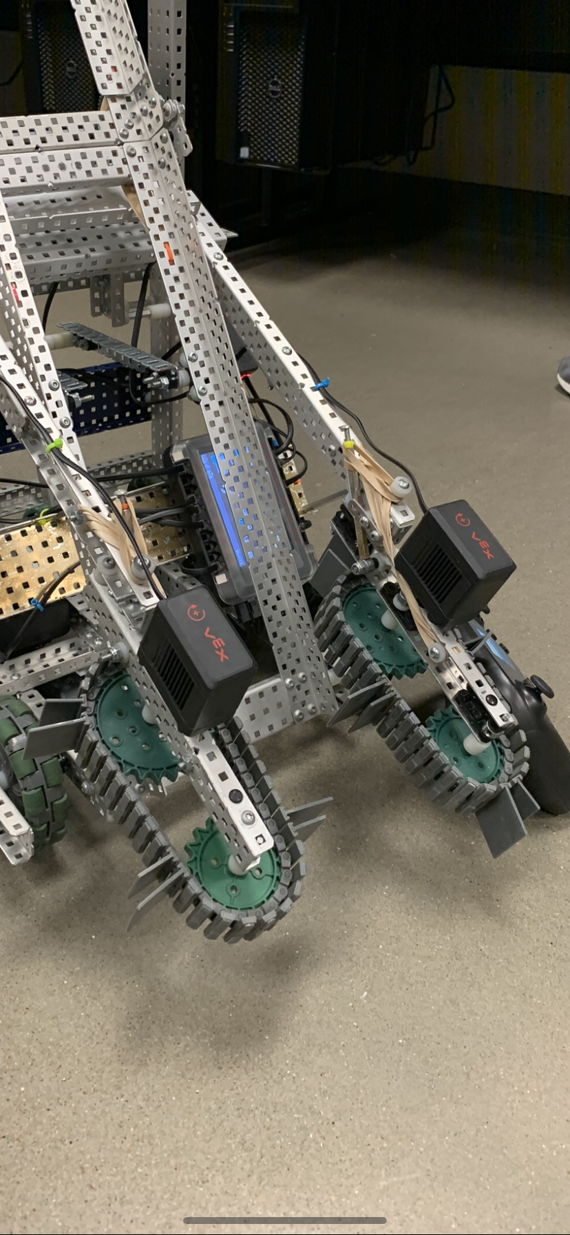

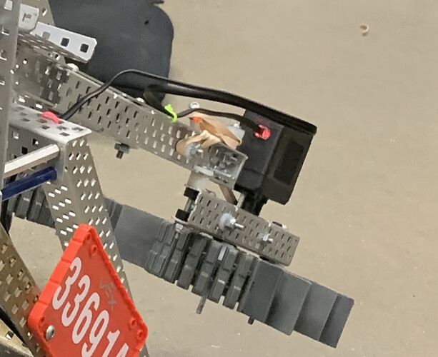

I appear to have the same issue my intake is just flex’s outward after picking up 7 cubes… I have the same mech as 448X and have tried increasing to almost 3 #64 rubber bands
Here are some pics
image image image
Any help would be greatly appreciated

I have the same setup as you minus the axel that stops it from moving.
On the v5 motor, there’s a little hole in the casing around where the axel is supposed to enter. The color inside that hole is the same as the cartridge on the inside.
Red=100 rpm
Green=200 rpm
Blue=600 rpm
