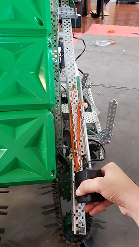

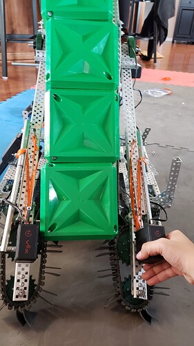

I have the arms twisting like this and do not know how to fix this so they can intake.

The issues you all are saying about the intake arms is not needed. It fits perfectly with the cubes. However, I say again, they twist and I need help on that and not other parts

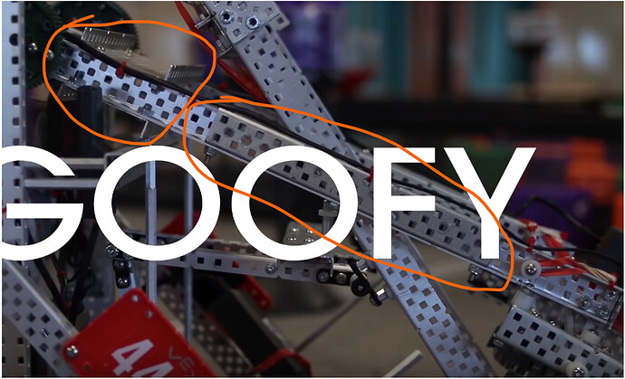

Try to box your roller arms with steel c channels and add more arm connections like 448 did. Also, improve your build quality will solve a lot problems for your robot.
@sarah_97963A do they have to be steel? Also, what do you mean by build quality?
Build quality is a very general term learned over time, just make sure all your joints are supported and brace where needed.
Ok. Also, the c-channels are faced upwards not sideways
Steels are less likely to bend compare to aluminum c channels.
@sarah_97963A why would they bend? Also, I don’t quite get how the boxing would help because its attached to the channels.
steel c channels are also less likely to twist, which is the problem you have
@sarah_97963A but the steel ones would be attached to the aluminum ones, and the aluminum ones are twisting

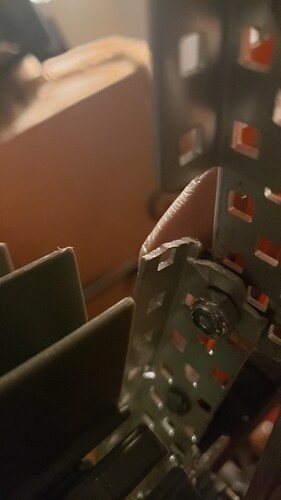

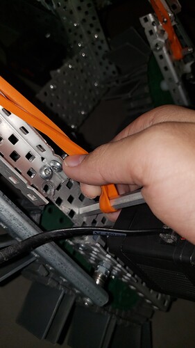

Can you post a picture of the joint your intake is on more closely, I think that is your problem area.
The arms to the gears or the pivot point?
The pivot point (20 characters)
try replace the twisting aluminum c channels with new ones and bolt steel c channels on them
@sarah_97963A they’re not twisted but twist out as its intaking, and pics:
