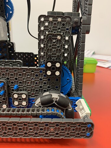

IMG_2657 IMG_2658 IMG_2659

Looks pretty standard setup. You have both ends of the axles supported and the chain doesn’t look overly tight.
What’s the drive ratio off the motor to that 12tooth gear that’s driving the wheel? (Picture 1)

The gear ratio is 5:1
In the code the team hasn’t set RPM, but when testing RPM via the brain (and not under load) the RPM of the left motor is 87mph and right motor is 92mph.
Thanks Ethan. The robot is reasonably heavy and when it is not under load (on its side) the drivetrain is extremely fast.

Hmmm, that’s an interesting problem. One time I tried doing a 5:1 drive and it just didn’t move. I’m guessing your bot has just enough weight to let the drive move it, but just not enough to keep it going? I would recommend trying a smaller gear ratio to give more torque (perhaps 3:1). Use the same motors to find out if it’s a problem with the motors.
two things you can do to potentially fix this- first is the most sure-fire way (assuming it’s not the motors themselves causing a problem) and includes simply changing the ratio to something that provides more torque as noah said.
the second option im about to mention may or may not work (depending on some variables in iq im not totally familiar with) but you can try it if you feel that you absolutely need that ratio for whatever reason-
you can try distributing the power differently; instead of focusing it all through that one small 12t gear, you can try adding another gear train of the same ratio somewhere else on the drive to share the power (maybe at the other wheel, or something like that. just make sure both wheels are going the same speed lol). a problem with this is that it will undoubtedly increase friction, although this could probably be made negligible. i did something similar to this last year with my 300 rpm 4” drive in vrc and while it took some tuning it worked pretty damn well
(the reason why this second solution may [or may not] work is because it seems to me that the poor plastic 12t gear in your drivetrain simply can’t handle all the stresses of accelerating to the speed you want. it may be bending, experiencing micro warping, or leading to something similar in the shaft, but either way it’s pretty clear something in that design isn’t holding up to the 2m worth of power going through that little gear. if you arent already, you can also try using a metal shaft just to see if that changes anything)
