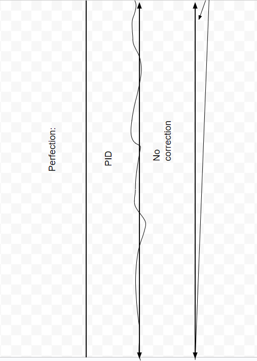

Hello, I’m having an issue with motor drift where in both autonomous and driver control the whole drivetrain appears to drift to the left and this is annoying to deal with especially in autonomous so any help would be appreciated.
Hi there, (your post should probably be under drivetrain and building tips) you need to provide more information about your robot. A photograph of the underside would probably be quickest so we can see what the drivetrain layout looks like.
But, I’m going to make a guess: you’ve got omniwheels in line with each other on the left and right of your base. In this case, there’s nothing stopping it drifting sideways because the omniwheels don’t provide lateral constraint. Push it sideways while it’s supposed to be stationary and you’ll see. In this case, minor distortions in the build either as static structure errors or bending during application of forces can deflect the drive of the wheels slightly and allow that free sideways mode to go wherever it conspires.
There are a million ways you can go to fix it, too, and assessing that would take more information from you anyway, so go ahead and post pics and description :slight_smile:

This won’t fix the driving but in auton you could use a angle correction pid something like this :
