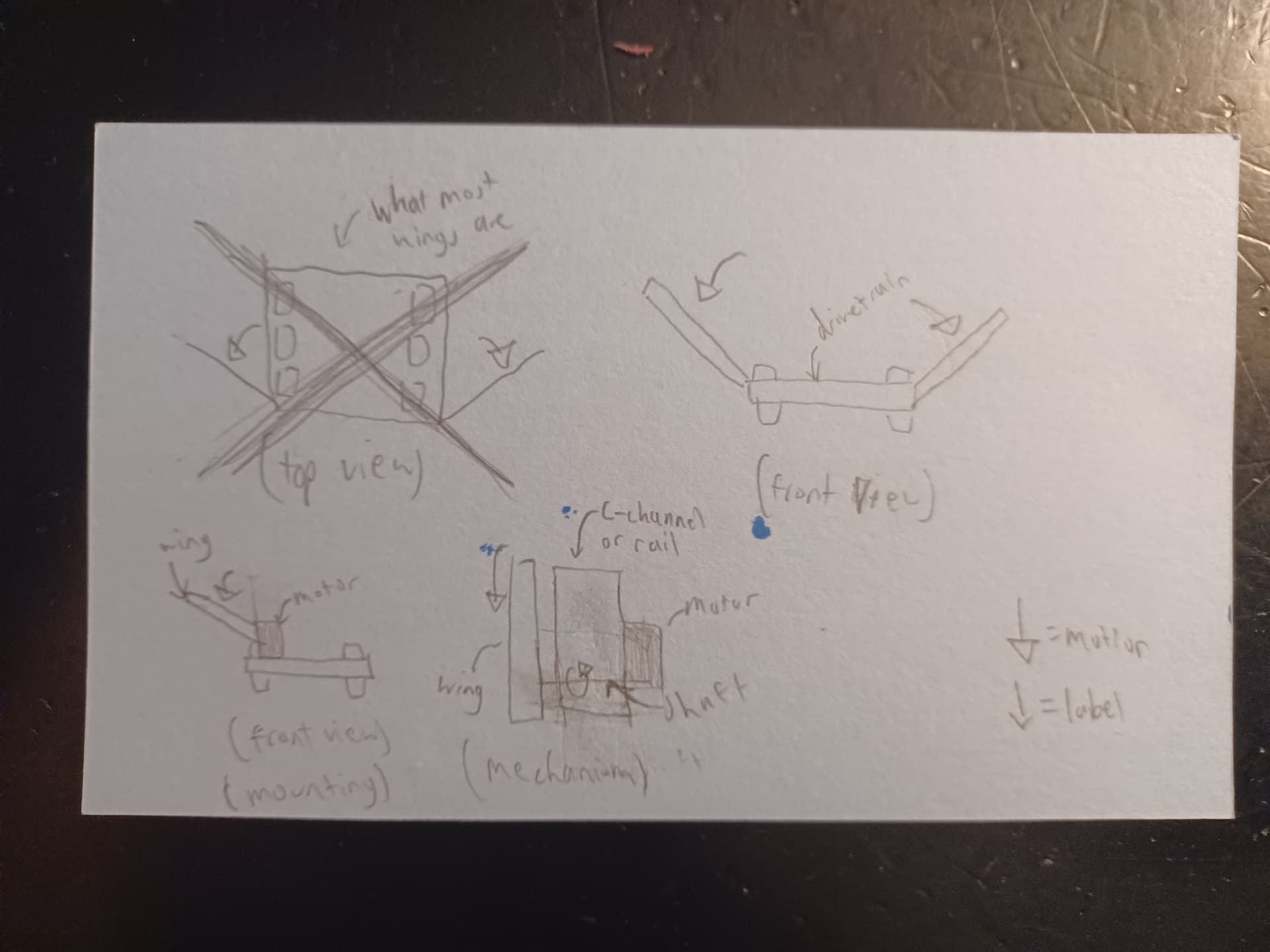

We are attempting to build wings using motors since pneumatics are out of stock. Below is a picture of what we are trying to accomplish.
  1. What’s the best or simplest way to attach the motor to the frame?

If you’re using motors, i would do vertical wings.
  1. Use a c-channrl flange to mount the motor and wings, then use a few 90 degree gussets to attach it to the drivetrain
  2. Vertical wings would need no lock, just a well build High stregth shaft attachment. Since you’re pushing on them horizontally, the force is perpendicular to the rotation of the joint, locking itself
  3. I don’t know the plastic type, just check to make sure the plastic type and thickness is legal
  1. This is probably best for your teams to figure out with their own experimentation, although you can use lock bars to attach the shaft to the wing or, like you’ve shown in the picture, use a gear. Something else that I think can be explored is to make the wings flip out vertically, as discussed in this thread below:

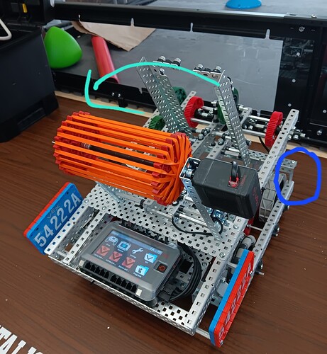

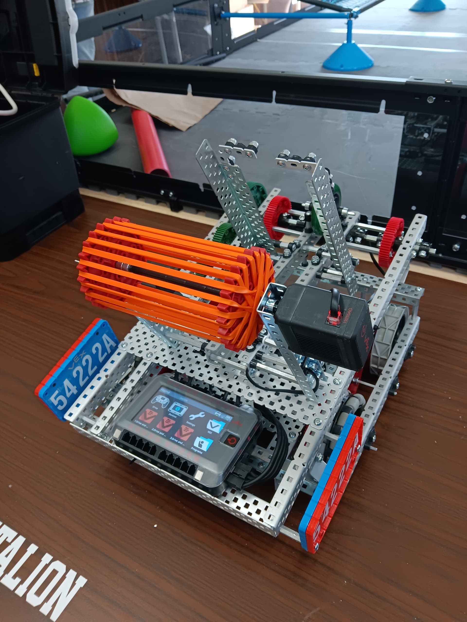

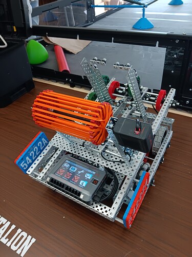

This is a picture of our robot. We are wanting to add wings to it. After we add the wings we plan to shorten the intack and add a catapult. For this post we are concentrating on adding wings.
Just curious, if that is a modified hero bot, wha does it look like extended?
For wing placement though, put it on the side closest to your center of mass
Assuming the intake flips put along the green arrow, I recommend you put the wings on the corner where the blue circle is and on the oposite side too. However, I also recommend that you shorten your intake flip out significatly to prevent your center of mass from going too far from the wings.
(Quick note, space the wheels out more to prevent tipping)
Currently the intake is on an arm that moves forward and back. The picture shows it in the back position. We plan to take the arm off and shorten the intake up front in the center.
If we connect the wings to operate vertically what piece would you use so that it moves smoothly? I know we would need to mount a motor on each side as well.
The last modification we plan to do is add a catapult to the rear over top where the brain is. It’ll need to be motor oporated.
Our robot is a modified Stryker Hero Bot.

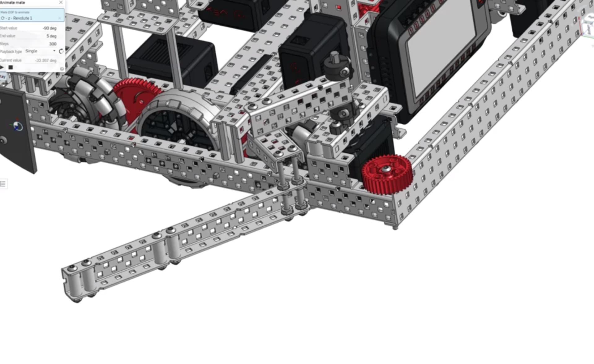

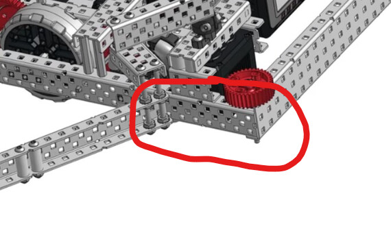

However, this area:
Is considered concave, and would therefore not be plowing but possession, and you might get a violation for that. Move it up about 4 or 5 holes and you shoudl be fine.

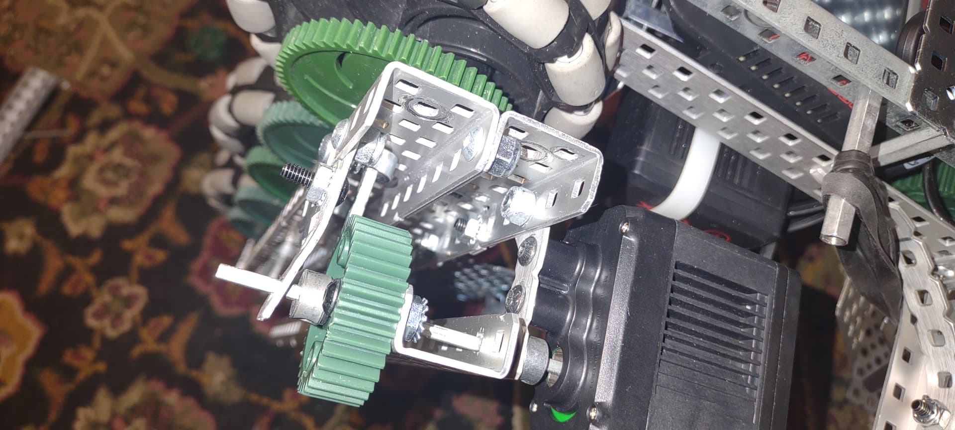

and here’s a pic of the hs 36 gear I mentioned before

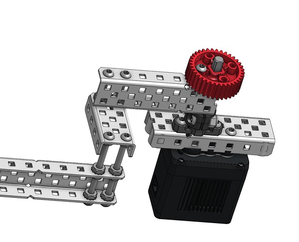

The picture you attached is actually my picture (I’m flattered lol) I think I explained this is in a different forum but I’ll explain it again
The motor is hanging off of a 90 degree angle pieces which is attached to the side of the robot, an axle is going through the motor and a 36 tooth gear sits on it. That gear is screwed onto a C channel. So when the gear spins the wing goes with it.
My main suggestion is to use 5.5w motors for it. There is a good chance you might not have them (or even know what they are, For some reason teams aren’t using them) But if you do you’ll save yourself a motor
As far as coding we just have it set to 50% speed and 100% torque, so if you changed to 5.5w motors the speed wouldn’t change

Not really under my interpretation of QA 1688. If the space that the possession occurs in is far smaller than the triball, it’s not possession. You still might want to make them flat though, as not all judges will have the same interpretation and it’s better to be safe than sorry.
