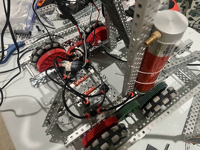

For some reason my puneamtics dont work. https://youtu.be/z6ghAeGOAN4
Can you give us a little better video, I would like to see the whole setup including tank, piston, and tubes
Is this good enough?
Make sure you put the tubing all the way in to the t joints, which prevents leaking. Also empty the air to make sure your solenoid is working. How you determine that is if you hear a light tick. Make sure all your connectors are screwed in tightly. Not all the way or you will break it. Trust me I’ve learned the hard way. If that does, then unscrew it with your standard star drive screw driver. I hope this helps!
To add on, you might also want to make sure that tubing is not cut at an angle, and that solenoid and tubing management is good (doesn’t make or break if pneumatics don’t work, but just good practice)
Yes, just make sure everything is pushed in all the way as well as tighten
it does thank you. I figured out one of my soelnids wasnt working
