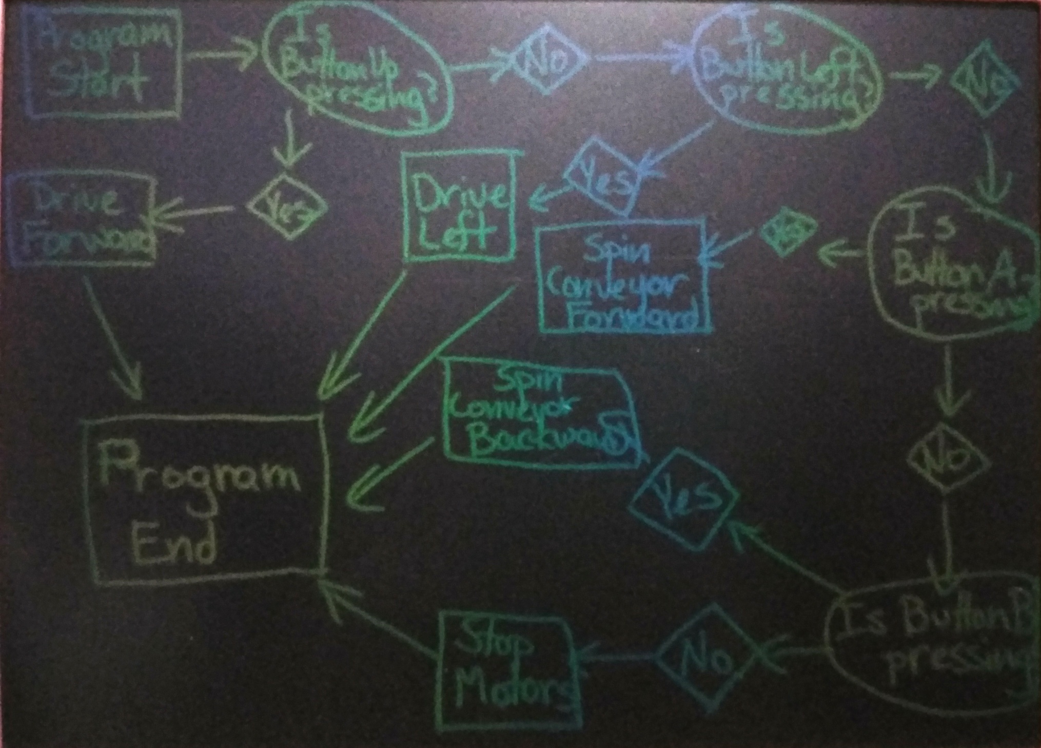

Hello My name is Evan Gonzalez and I am new to programing, so far I have not run into trouble when programing the controls but I have come across an issue that has halted my teams robot for the game tipping point. I have already programed moving controls and and a conveyor belt control but when we use the program we can not simultaneously use the different controls can you please help me.

I believe the issue is that all of your controls are in 1 if else statement. Try making it so there is a separate if statement for each button and or joystick.

That’s exactly his point. Suppose you have code like this:
if (ButtonUp.pressing()) {
  Drive.spin(forward, 100, pct);
else if (ButtonA.pressing()) {
  Conveyor.spin(forward, 100, pct);
The computer tackles it line by line. First, it says, “Is ButtonUp pressing?” And if ButtonUp is pressing, the computer will execute the code inside the the braces and drive forward. Then it will get to the next line and say, “Oh, the "if" is already true, so I don't need to do the "else if",” because the else only runs if the the if and all the else ifs before it weren’t true.
I drew a flow chart of some of your program to illustrate how the computer sees it.
If you still don’t understand, I would recommend reading this chapter. While it’s specifically about Python, not C++, the same principle applies, and I think it will help you understand if/else statements.

This is almost correct.
and then there is the fact that you want the button movements, instead of the joysticks. This would be cone by this code:

This would make your drive function work by:
  • Only letting your drive go one direction at a time
  • Letting motors not on your drive work while the drive is working
The full code for this is:

Now, I add this sentence at the bottom of the code, where I know there is a good chance that it is ignored.: Please do not just copy-paste the code, sit down, and think about what each piece of the code is doing. Also, please draw a flow map, similar to this one,
where you analyze the code as if you were a robot. After you do that, feal free to use the code
