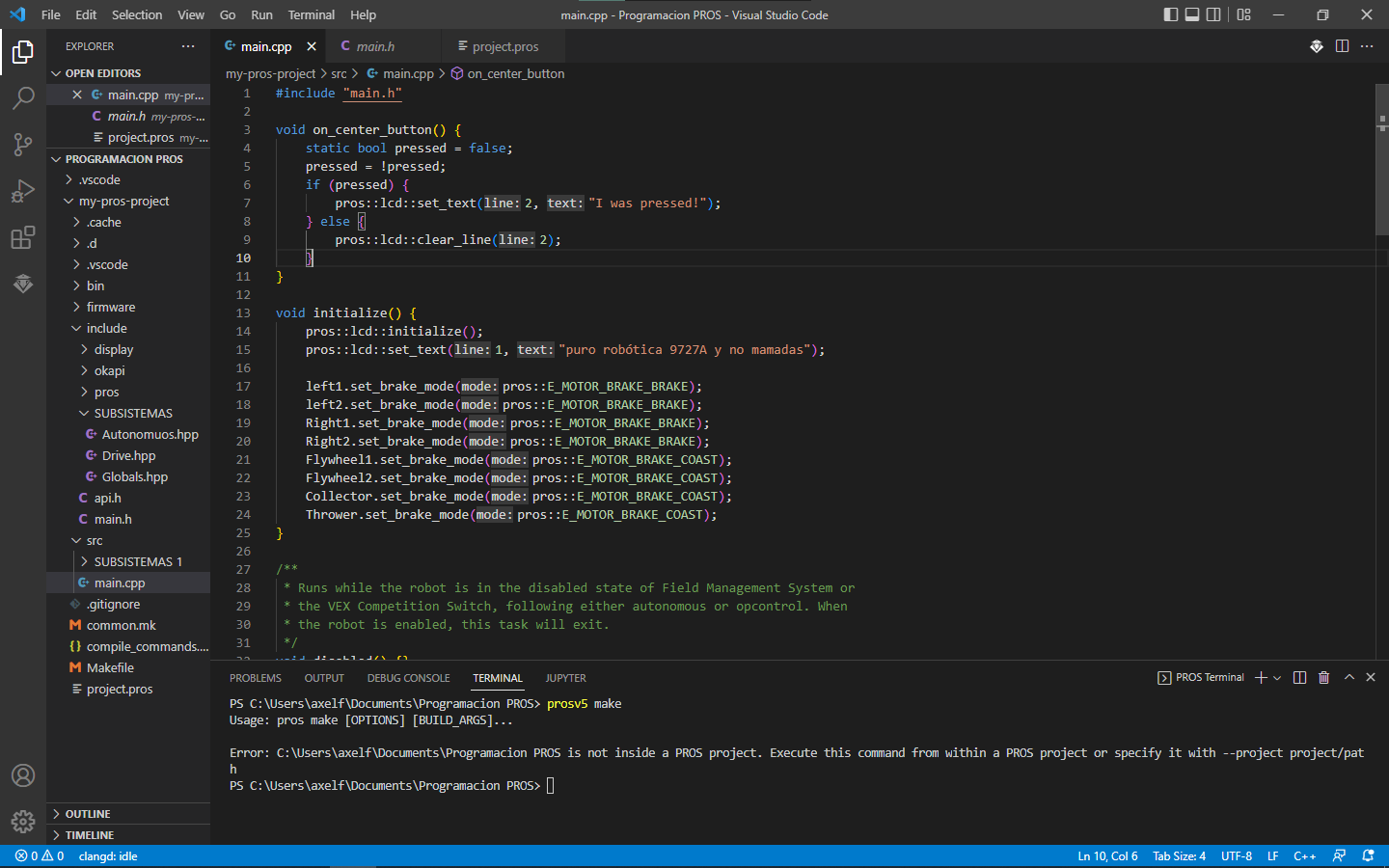

thanks, if it worked for me but now when using " prosv5 make" the error “C:\Users\axelf\Documents\Programacion PROS is not inside a PROS project. Execute this command from within a PROS project or specify it with --project project/path” what do I do now?
If you look at the file system sidebar, you can see that you are currently in the folder called “Programacion PROS”, not the actual project which is called “my-pros-project”. Do File → Open Folder → choose “my-pros-project”. This folder is your actual PROS project, and needs to be open for the commands to work.

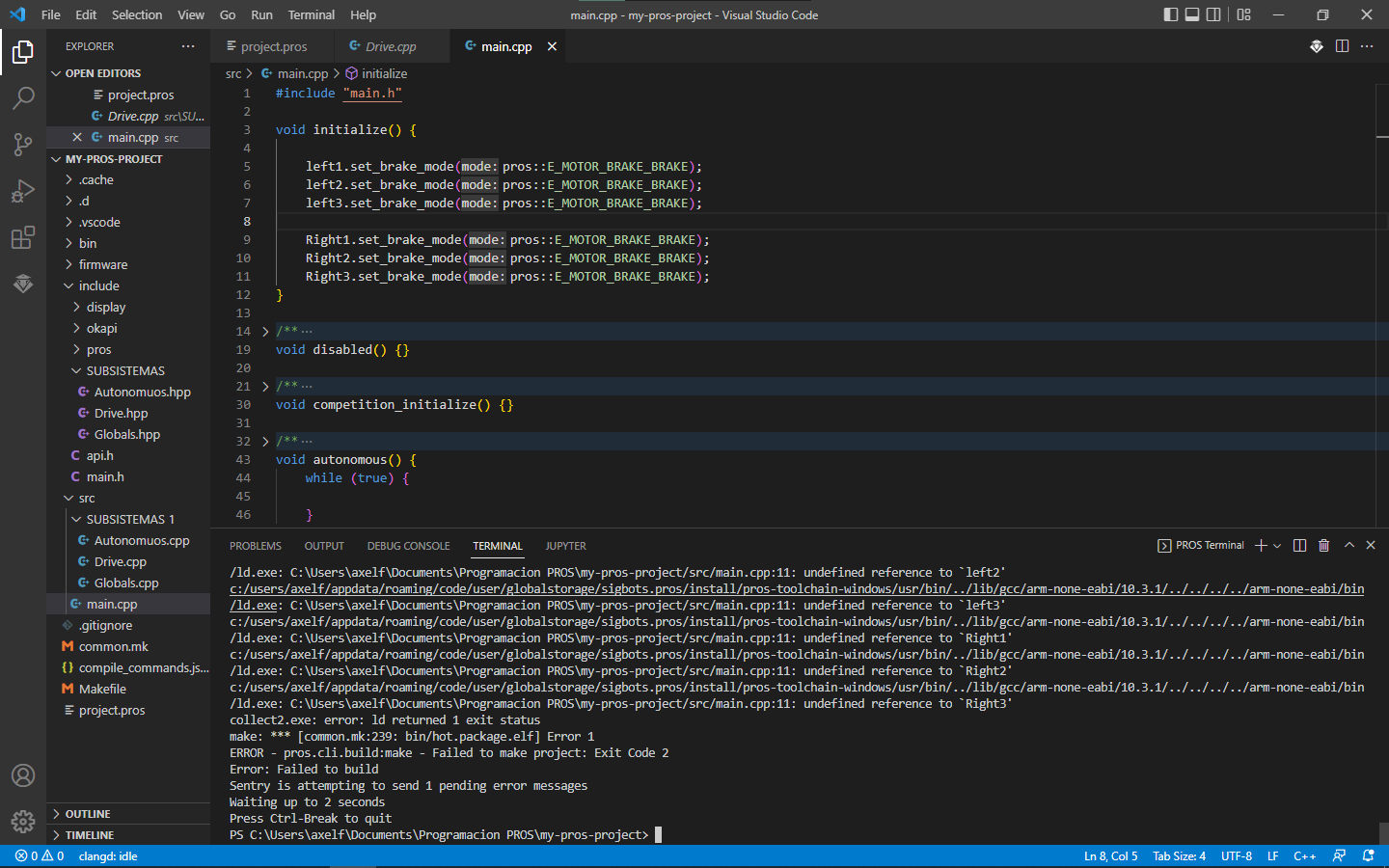

thank you very much, if it worked for me, only now I have a little problem. At the moment that I use “prosv5 make” another error arises xdd
“ERROR - pros.cli.build:make - Failed to make project: Exit Code 2”
because of this it does not allow me to update the code as such
It would appear you have a linker error (you are doing something wrong with having multiple files). From the limited code I can see, you have undefined references to all of your devices (left2, left3, Right1, Right2, Right3). You can either look into this yourself, or provide more of your code so that others can help you. This is user error, not an issue with PROS.

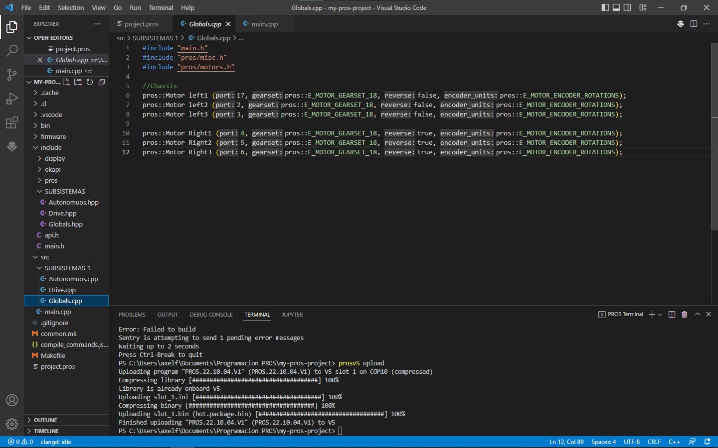

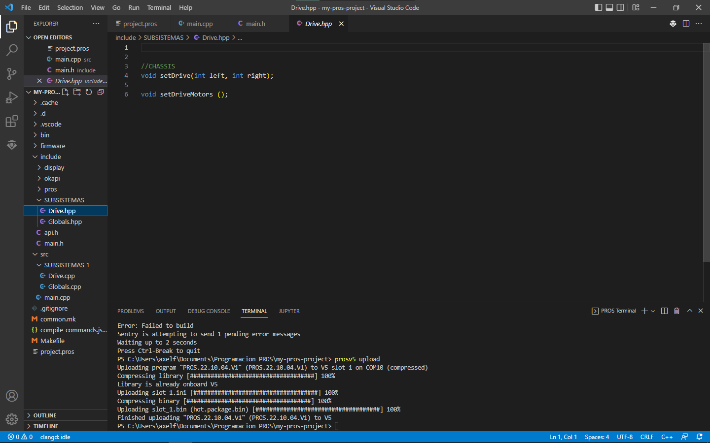

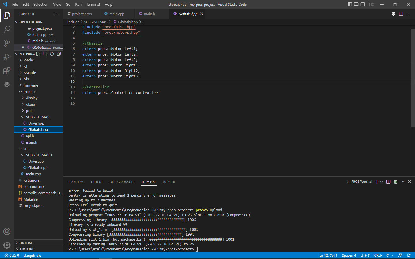

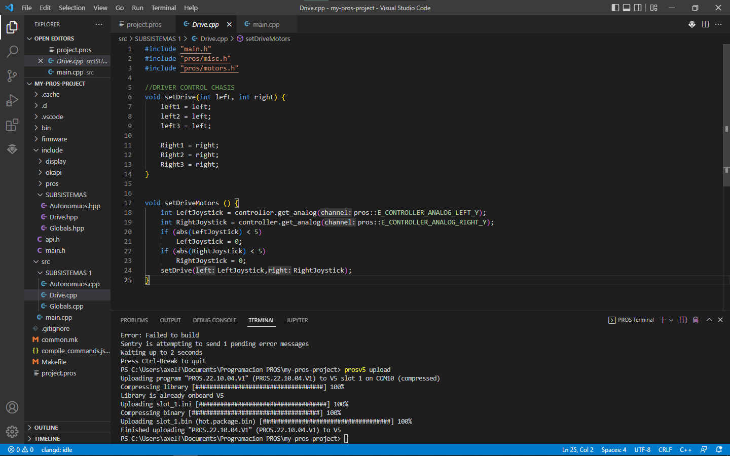

this is all the code, it is something basic but do not expect much I am new in PROS and it is only for a test chassis to 6 engines
Uploading: image.png…
Yeah…. This is not how you use header files properly. Going to give a brief example and hopefully you can transfer this example to your entire project
