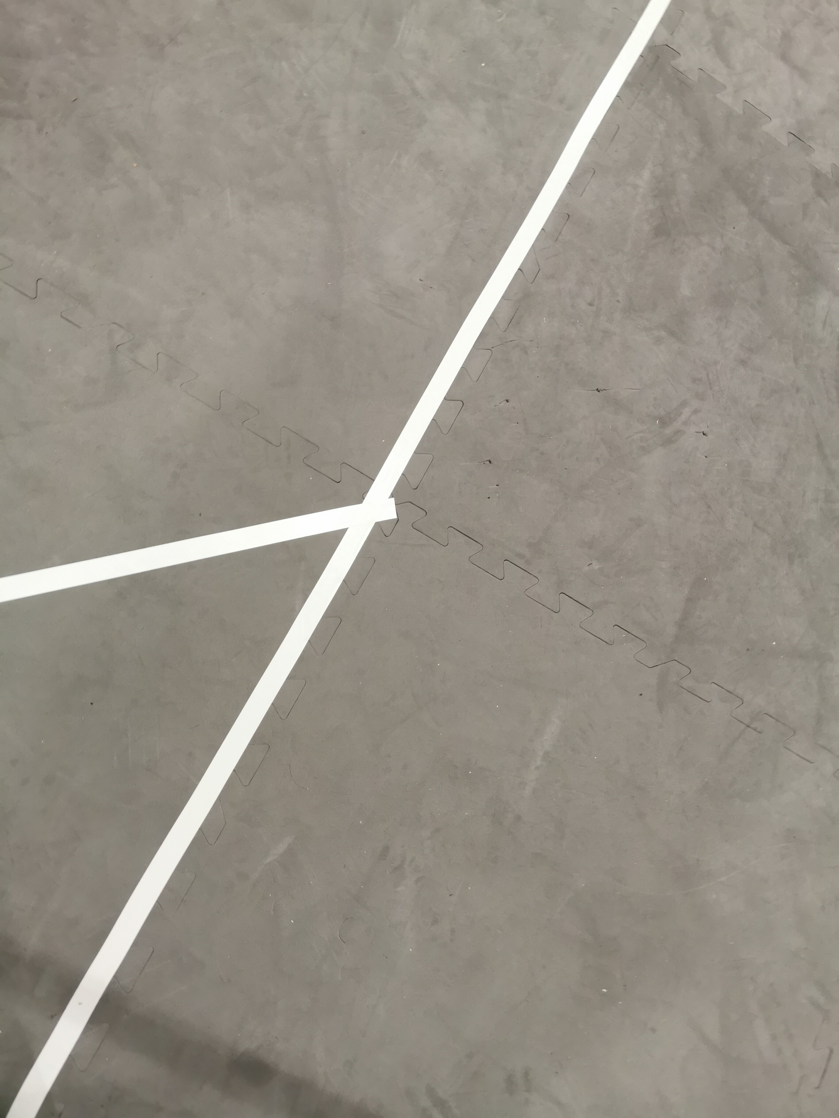

Does the tape need to be perfectly layed or is it allowed to have some minor imperfections? For example not being 100% straight or overlapping a bit as shown in picture…
Well, what is it for?
Our field’s tape isn’t perfect, but we just have it for practice. If it is a skills field only, then the auton win point line doesn’t much matter, so you can probably have some slop in that, but the lines delineating the different zones are absolutely critical for scores, so you probably want that to be perfect. If it is a matchplay field, then you probably want it to be near perfect.
Don’t be that line striper in soccer who is too busy reading texts to notice lines really off.
I would get rid of overlap and pay critical attention to AWP clearance line - it matters.
For competitions it looks better if lines are straight, but I highly recommend teams remember to allow variances in the field set up.
