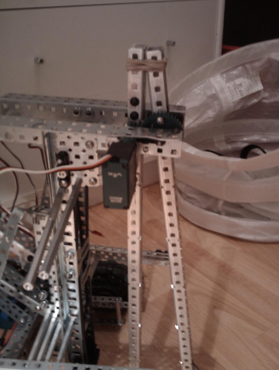

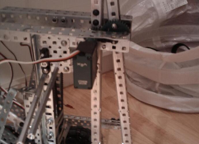

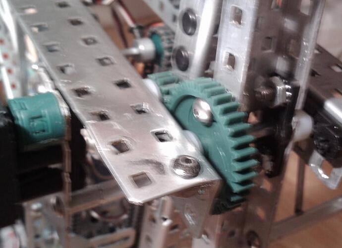

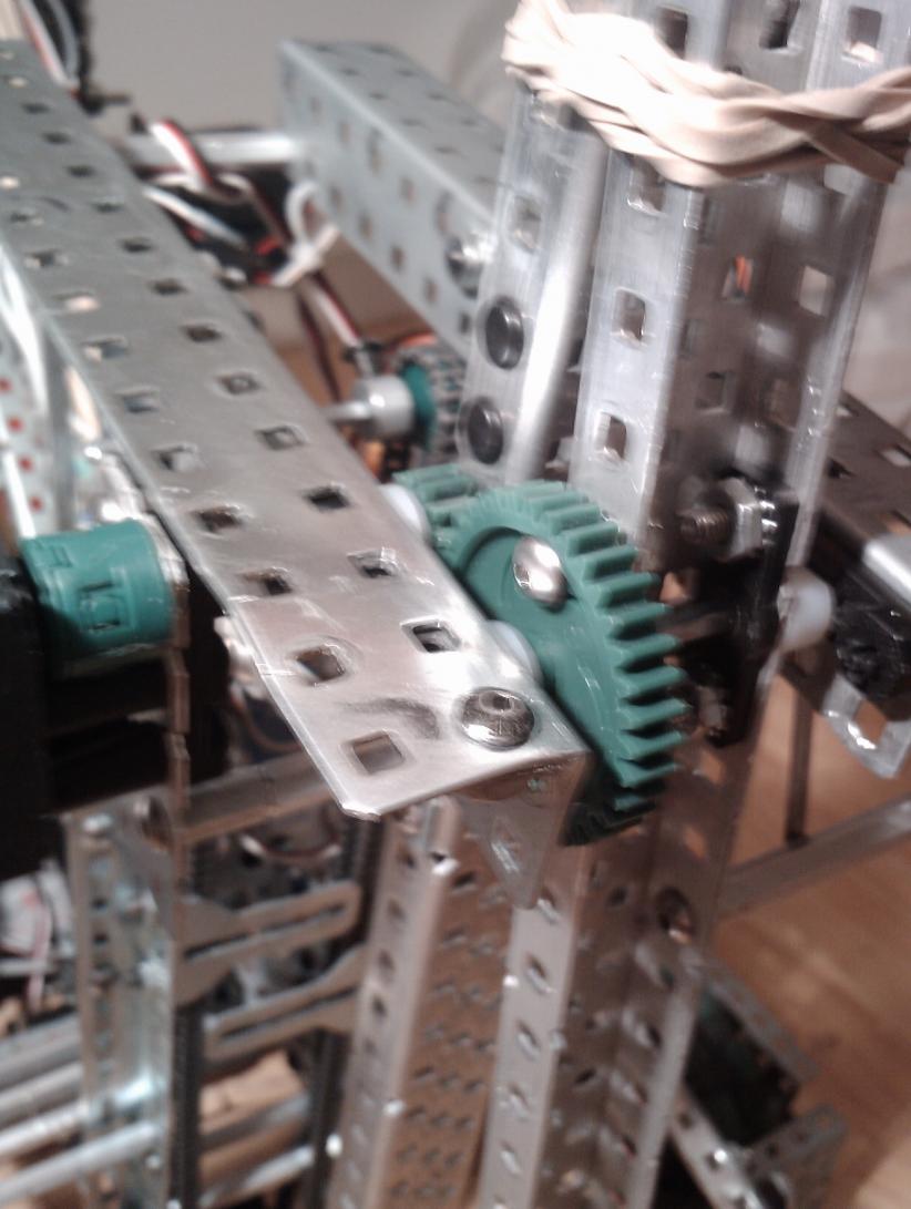

I would like to press a button to toggle turning a motor a certain direction that would turn until I pressed that button again. How would I do this? I am using EasyCv4
I have this “chopstick” mechanism that is geared 1-3 . When the motor is on , the chopstick would come together and when it is off , it would come apart. Currently , I have to hold the button to keep the chopsticks together. I want to be able to use a toggle to keep the chopstick together.
