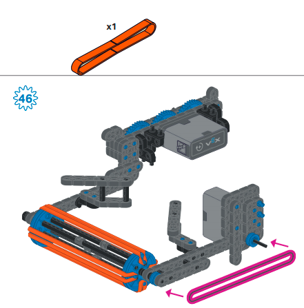

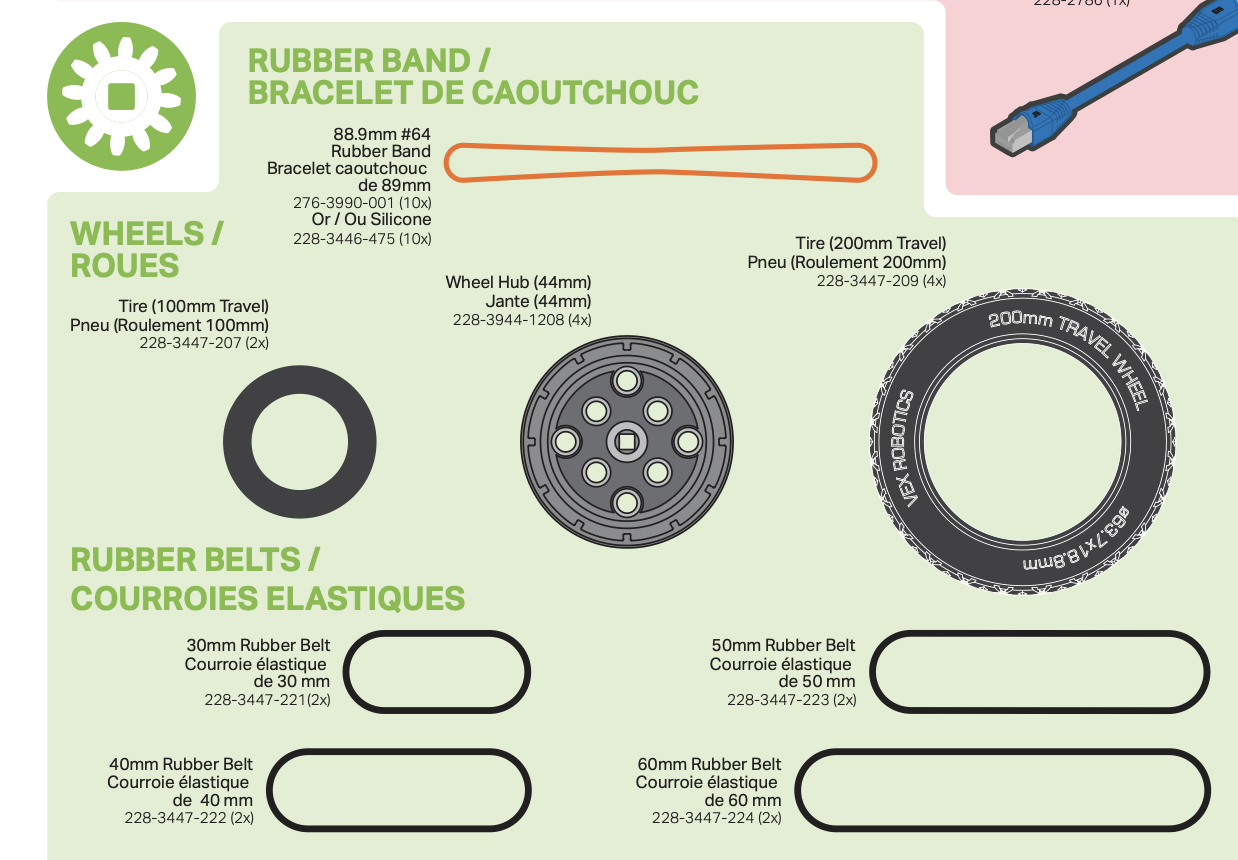

I’m having a different problem. I noticed that this uses the pulley but I don’t think that I have any of bands used for the pulley. The instructions actually show a rubber band, would that work in this case?
Personally I haven’t tried it, but it looks like it should work fine. If you do try it, I’d like to hear how it goes.
The belt is similar to the ones here https://www.vexrobotics.com/iq-pulley.html I’ve had success with rubber bands.
There are some of those belts in the IQ Super Kit:

As you can see in the actual image of the intake, it is meant to be a belt, not a rubber band.
The part that should be shown at the top is the 60mm Rubber Belt (228-3447-224).

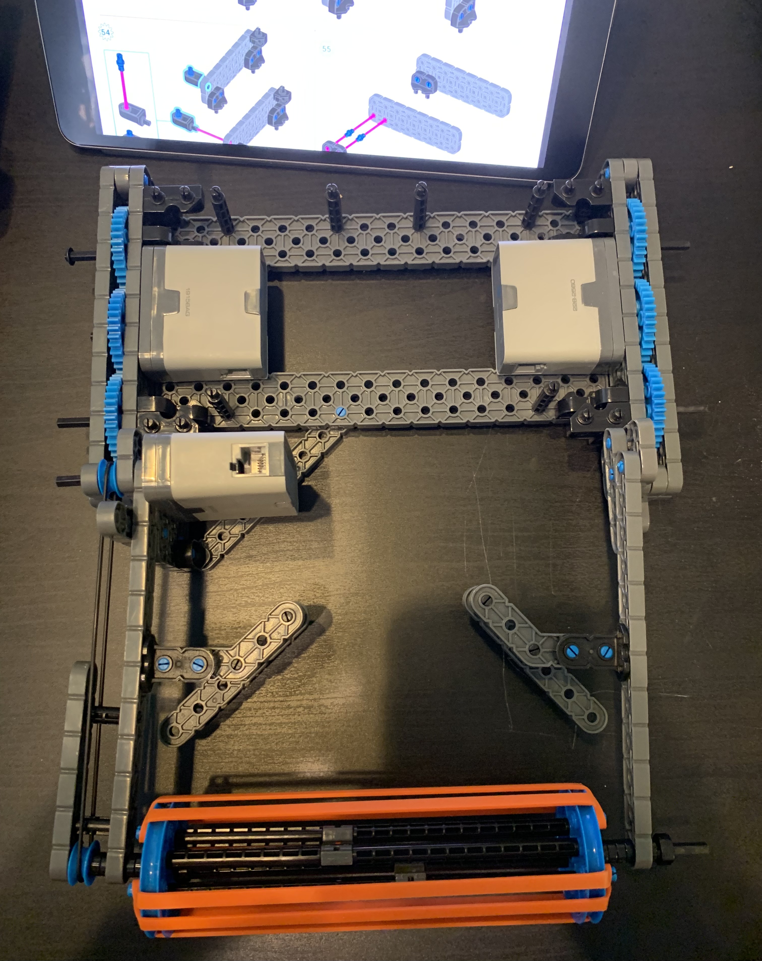

Finally got around to building Fling this weekend, some of my notes that I haven’t seen yet in this thread:
The 60mm belt driving the intake had to be stretched very tight to fit – so much so that it racked the whole intake assembly quite noticeably:
(I remember it looking worse IRL than it does in that photo)
I replaced the belt with a #64 rubber band, which required much less tension and actually worked pretty well – I was expecting the rubber band to slip off considering that a pulley for a flat belt would usually be the opposite shape. But the rubber band spun the intake just fine.
However, when I tried to intake a Turning Point ball (the only thing I had around the house that was the right size), the rubber band slipped against the pulley before the ball came in all the way. I switched back to the 60mm belt and it was able to intake the TuP ball – but it really is bending some of the plastic parts a fair bit, I will definitely be taking that belt off for storage. Rise Above Pitching In balls weigh just under half what the TuP balls do, so it’s possible that the robot would intake the PI balls just fine with the #64 rubber band. Bank Shot/Squared Away balls would’ve been a better analog but I didn’t have any handy.
I also experienced a lot of problems with the pullback mechanism getting caught on itself. I replaced each of the shaft bushings with a pin and a spacer and that made things run much smoother:
Looks like the pins stick out from the gear a hair less than the shaft bushings did, which is just enough for them to clear the 1x6 beams as they pass by.
