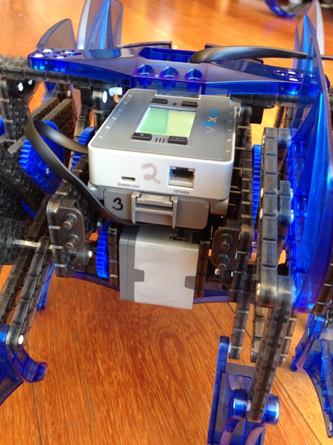

Wanted to add that I went ahead and did the “brain transplant”, put in a VEX IQ brain and motors instead of the standard ones. The whole process took 15 minutes, and it works GREAT. The robot moves much faster, and the VEX IQ controller is easier to use.
The VEX IQ motors exactly replace the smaller motors, and the brain fits nicely between the central plates using standoffs. You can use the standoffs from the Strandbeast motors! The top and bottom beams fit exactly as before. I used slightly different braces to attach the faceplate, so that it can be removed easily for battery replacement.
It works with the driver control program as-is, though clearly there are opportunities for a more customized software approach.
I would highly recommend this kit to a school that already has VEX IQ, since it gives access to some interesting parts and mechanisms. (Probably not qualified for competition?)

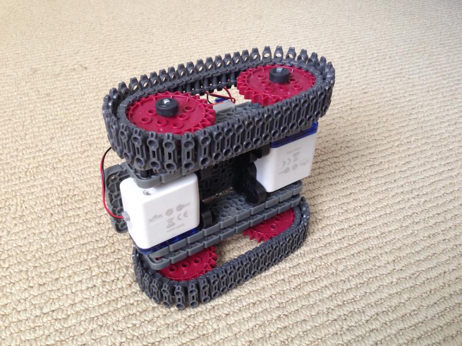

The motors, sensors, brain and controller that came with the Strandbeast can be used to make an RC car or lightweight robot with VEX IQ parts, they work really well with a lighter build.
I’ve done the swap for all the Hexbug. Spider and the Ant are the hardest to do since the IQ brain is much bigger than the Hexbug version. But the extra in the motors makes it worth while to do. I’ve been starting to “kitbash” on what I can make when I mix and match parts.
And here’s what I did with the Strandbeast original brain and motors.
Here’s the strange thing: the thing in the picture works perfectly. The motors work fine as a skid steer setup. The lights work fine, basically both green when moving forward, red when moving back, and green and red when turning, with green in the direction of the turn. However, this setup has NOTHING to do with the instructions! Note how the motor connector is upside down, and one of the LEDs is flipped! It doesn’t work any other way!
I am still trying to figure out a way to get the sensors to work, currently most configurations I try lead to one motor turning constantly.
It would be great to have some detailed “behind the scenes” instructions on how that little brain works.
