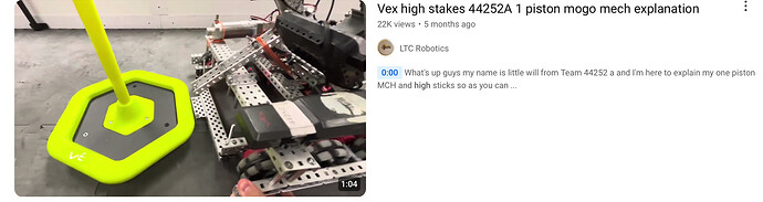

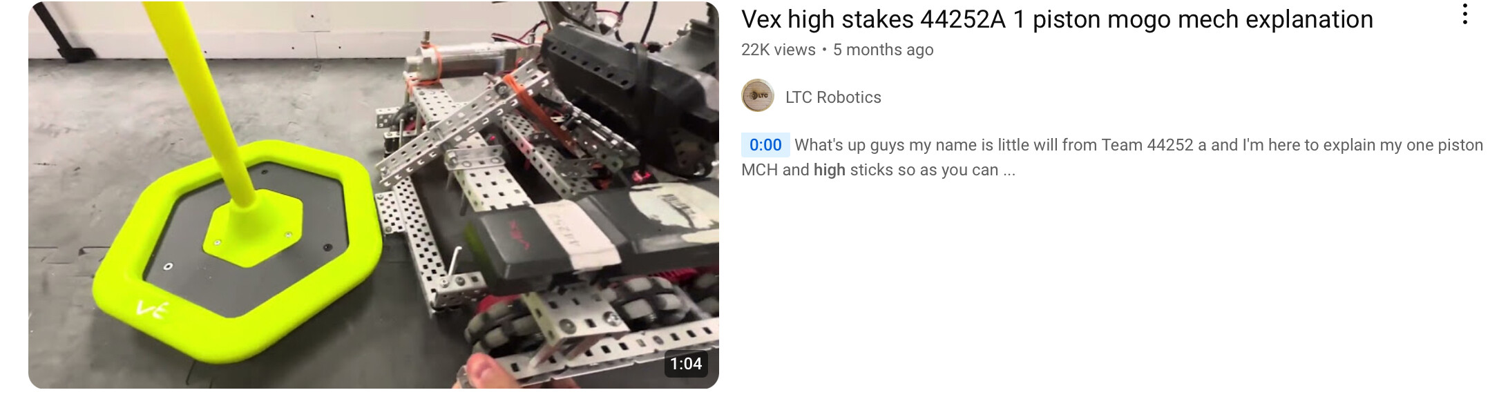

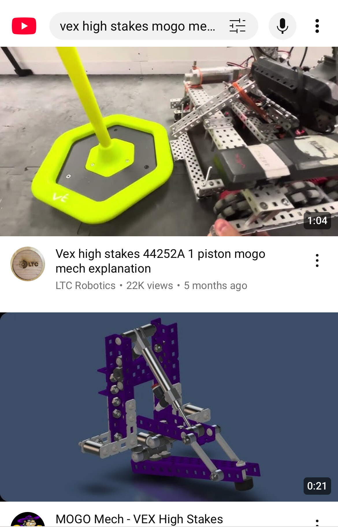

Generally, good mogo mechs are simple clamps powered by 2 pneumatic pistons that push forward on the top part of a metal bar so that the lower part is pulled towards the bot, which would clamp a theoretical mobile goal in the process.
As a guide of course no one will tell you how to build it but there are people demonstrating it on YouTube. So I really think you didn’t bother to look.
Our team is the only team with a Pneumatics and we only have one because our school generally does not buy things for us. So is there a way to make it work with only one pisont and I will send the picture as soon as possible.
Yes, it is very possible.
Again, we’re not here to build for you. Make sure to keep your search broad, and also just take time to just play around and experiment yourself rather than relying on already-designed ideas.
No, I did check YouTube but non of those where really helpful to me because most use two pistons or just don’t explain it really well.
Adapt a design it’s not very hard to turn a two piston mech to one. The same concept applies.
Okay, thank you for the advice.
We use one piston and it works great. So it doesn’t have to be two.
