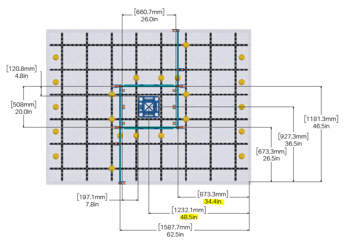

Longer field dimension
High goal center is 48.5.

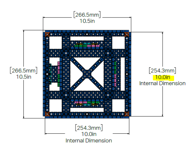

The high goal is 10" wide.
48.5 - 1/2 the goal (5") equals 43.5 on the edge.
Lower goal wall is 34.4.
43.5 - 34.4 = 9.1" from the lower goal wall to the edge of the high goal. (8 ft length)
Shorter field dimension
36.5 center - 5" (1/2 goal width) is 31.5"
Lower goal wall is 26.5
31.5 - 26.5 = 5" from the lower goal wall to the edge of the high goal (6 ft lenth)
Check my math. I make mistakes

These numbers are correct. Just to clarify in a slightly easier way (from the given bird’s eye view):
The distance from the vertical wall (taller but not as long with the plastic sheet, also connected to the hanging bar) is 9.1”. The distance from the horizontal wall (short but longer) is 5”.
