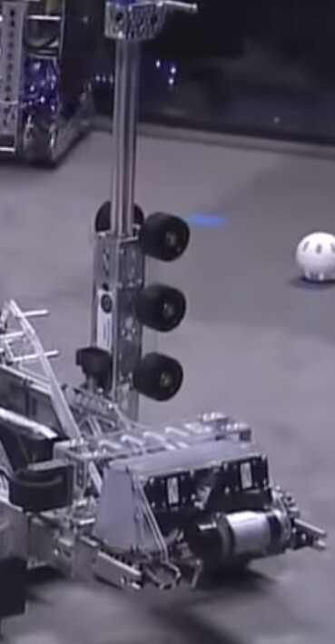

This is a place to discuss ideas for completing the high rise for VEX IQ: Pitching In. So far, my team has gotten stuck with this issue because each time we try to lift up the robot, it will hit the plastic sheet and then get stuck underneath the low bar. In past challenges that had similar problems to solve such as Next Level, robots were able to hang underneath the bar, with no plastic sheets stopping them. I think it could be possible to complete the high rise if something was pushing the robot away from the lowest bar, but that would require another motor that we don’t have. Anybody have any ideas about how to solve this efficiently?
What my team is doing i, so we have our high hang claw, which folds out from the robot, when it folds out, a hinge folds out with it and the hinge pushes the robot off the sheet
One thing you could do is have a set of wheels, attached to the robot, that “ride” the plastic sheet in between the 2 hanging bars. This is similar to what teams did in FTC Roger Ruckus:
(The wheels allowed them to have low profile hanging mechanisms while being able to hang in a short amount of time).
