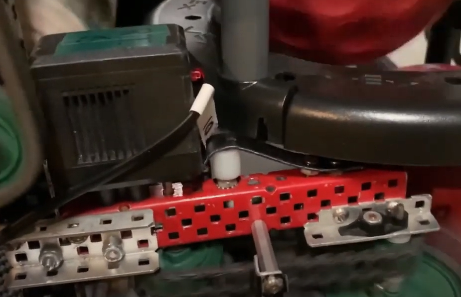

Another modification that I would recommend on this robot is adding something similar to 9181W that allow you to push up the goals slightly and intake balls faster. (Picture Below)
