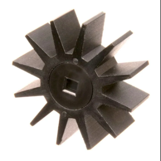

The majority of this season’s intakes are flywheels but my sister teams from last year lost 4/6 white flex wheels at states, I was wondering do you guys have any other ideas of intakes that do not use flex wheels. As of now we are working on 2 treads that will spin fast enough to be used as a intake.

An intake without flexwheels is tricky but, still doable. I recommend using intake rollers made by vex:
Screen Shot 2024-08-18 at 8.23.02 AM
You can also do a hook intake like1000A or JHAWK, both of these intakes funtion without the use of flexwheels and are pretty consistent with tuning.
