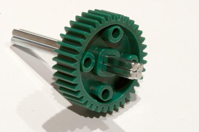

You may be able to make one from four axles. Unfortunately gluing & welding are not allowed.
[ATTACH]7535[/ATTACH]
Cool solution! Wouldn’t work in a lot of cases due to the need to interface with standard VEX bearings, but for some spots this could be a good workaround.
