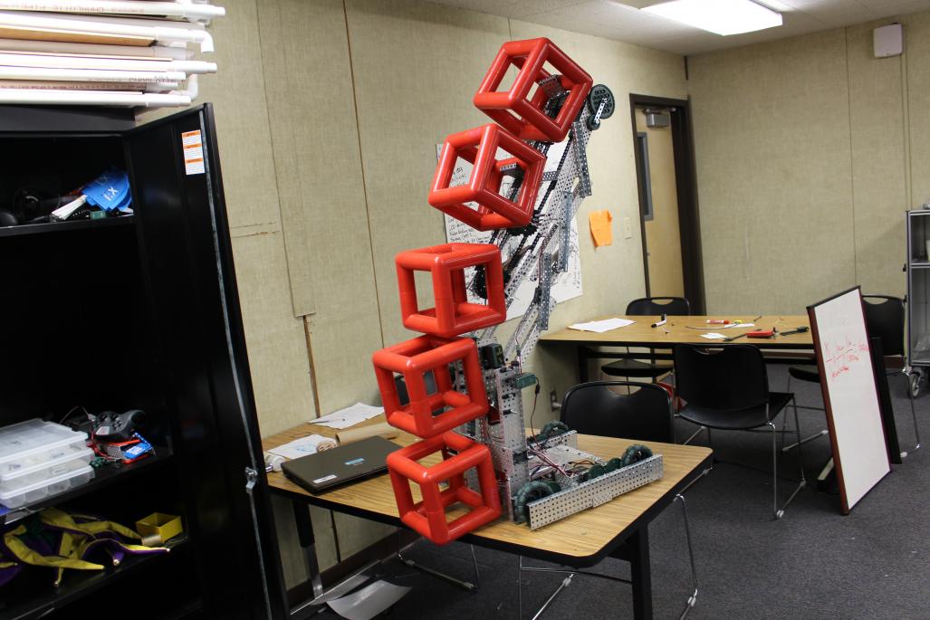

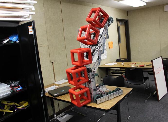

My team (36) had a claw on the front of our elevator lift that could grasp 3 cubes and a belt made of HS chain that ran all the way over from the front to the back of the lift for 3 more cubes. I have seen no other robots that could handle 6 cubes but sadly it has since been disassembled because it was unable to get higher than the medium goal.

We brought it to the Notre Dame Prep tournament. We lost in the semifinals because the load was too much for the chain running the lift. It began snapping link by link so we decided it was time for a change.

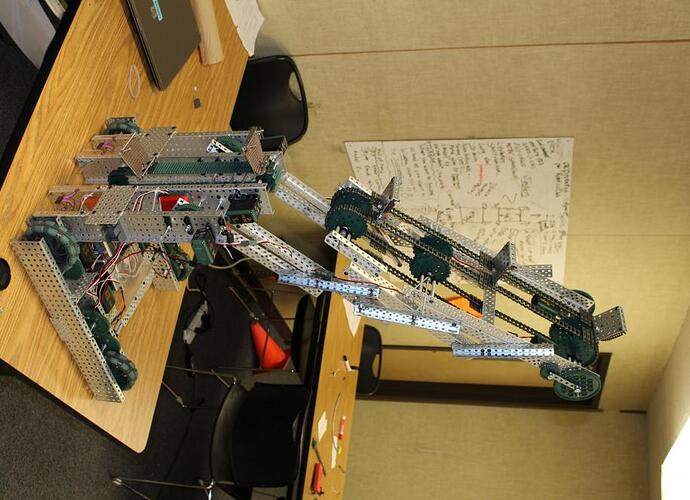

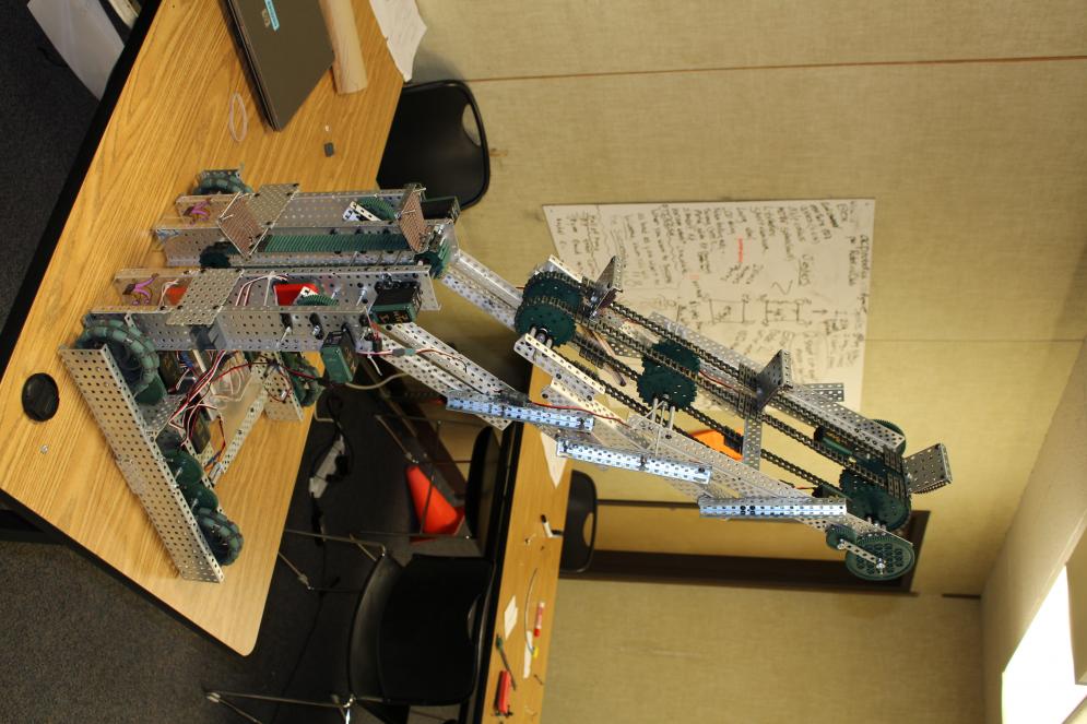

I found a pair of pictures of our robot, both loaded and unloaded- this is under construction
In case anyone was curious what it looked like
That is a very neat idea. I assume the conveyor on the back delivers cubes and “hands them off” to the conveyor on the lift?
Even if this didn’t work the best for you, it is a heck of an idea. I like it.
