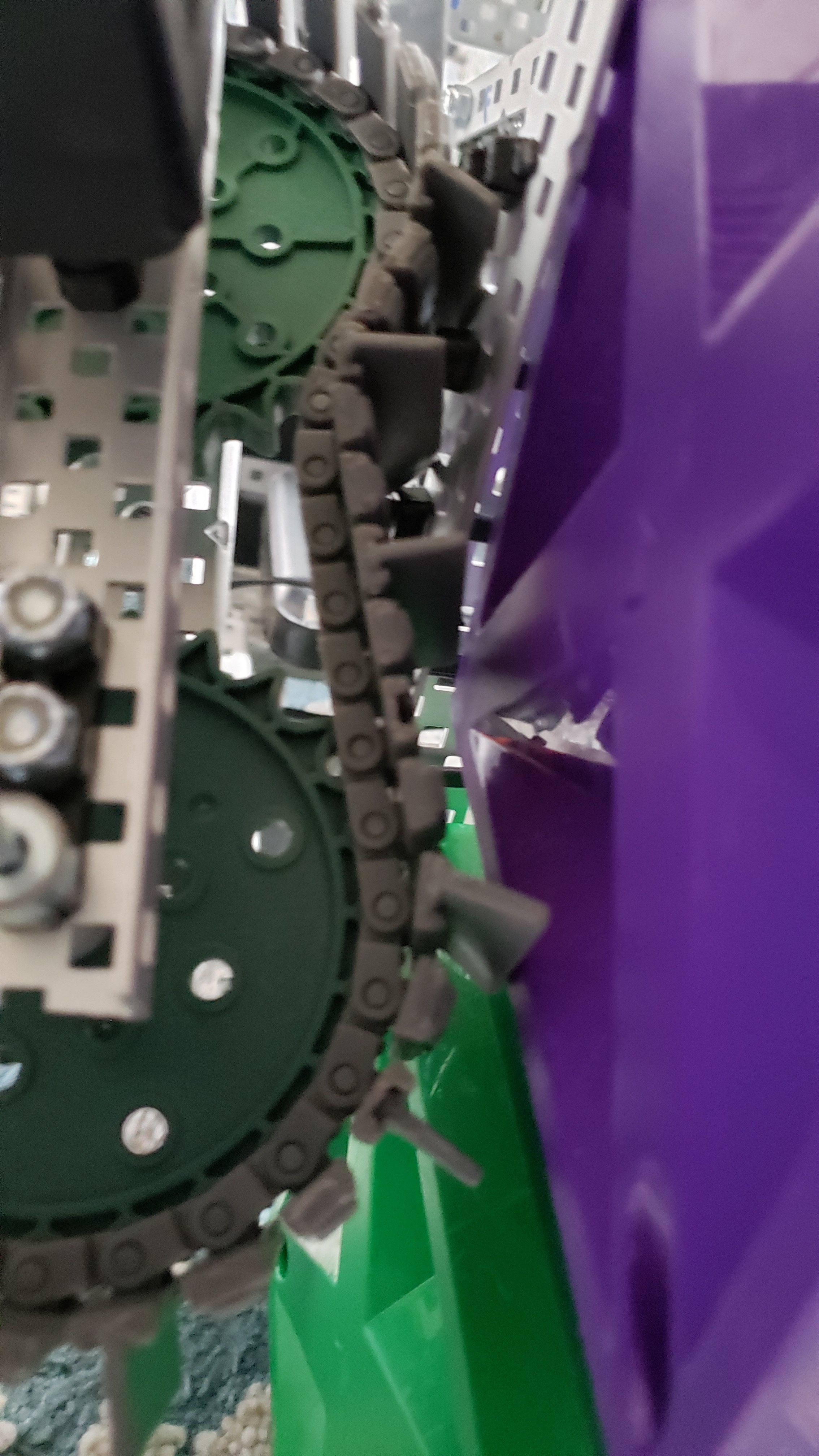

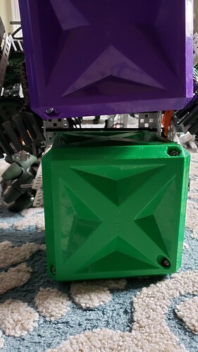

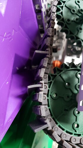

Hi all. Sorry to make another topic about the hinges, but this time, when I am stacking, the little flaps still grip the cube. The intakes arent moving out far enough when stacking. I have tried various things, like adding metal to the sides, adjusting angles, and pushing more to the side of the intake, however nothing has worked. Thank you for your time and I would appreciate your thoughts on this issue.

i have my intakes so it is a smaller sprocket in front and a larger one in the back. that should fix your problem right up
Hmm, it would fix it, but I have found this config would be better for intaking a lot well.
idk, mine intakes pretty good
You could just reverse the rollers as you back away
I would put spacers in between the hinge and the intake module so the intake module sits farther away form the rotation point. This should increase the distance it moves, but you may need to lower the entire intake system or where the intake sit to maintain your intake traction.
I currently have a 0.5inch standoff in there, and I believe it will only rotate to where the chain pieces are out of the way, and the flaps will still extend out and grip it
