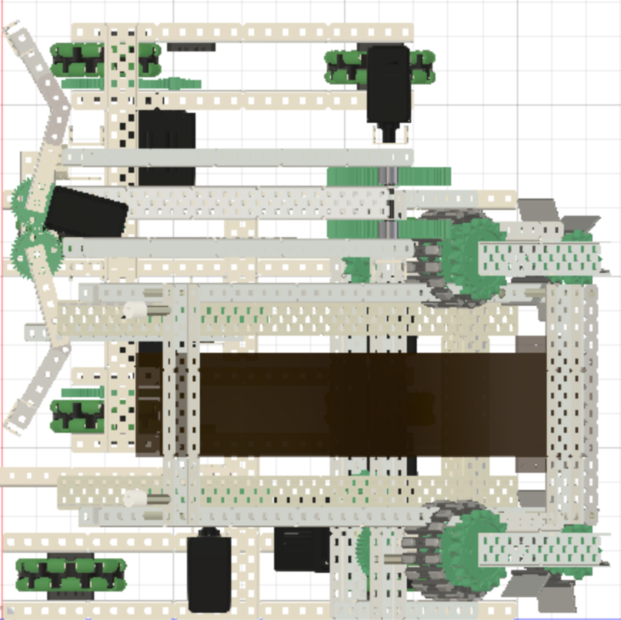

We were fed up of building the same robot as everyone else, so we decided to look at other designs. Everyone is building narrower chassis for robots, and we noticed that is was possible to slide two 25 wide chassis inside each other to fit inside the size limit. This inspired us to push forwards with a tether-bot design, with both a tray and a DR4B sub robot making up our design.
The 8 motor limit provided us with some challenges, and having to fit everything in such a small area was also a challenge. We designed a split tilter mechanism to allow for the other chassis to slide inside. We also designed a bar to mount the intake rollers to and transfer the power evenly to both rollers from one motor.
Our proof of concept cad:
ezgif-3-b0f09e73949a
Motor distribution:
Tray Sub Bot
  • 2m drive 200RPM 3.25" omnis
  • 1m tilter 100RPM 1:7
  • 1m intake rollers 100RPM
DR4B Sub Bot
  • 1m DR4B 100RPM 1:7
  • 1m claw

We felt that this design would provide more flexibility than other designs in matches, being able to do towers and 8/9 cube stacks, also we could easily score more in autonomous which would be good as well. We also thought that it had good potential in the skills challenge, being able to do two things at once.
More importantly than all that though was that it is just more fun than a boring meta tray, it was more fun to design and build. We also hoped that the robot would be really fun to play with or against as it adds a different dynamic to the game.
Unfortunately, we don’t plan on finishing the robot anymore, but I hope everyone likes the design. Any questions or comments let me know. I should be able to get some more pictures on Monday if there is any particular parts people are interested in.

Amazing concept those 1m intakes are really well built. I’m surprised we didn’t see more of that this year, but I guess there just wasn’t a second scoring objective that could use the extra motor. 18t 100rpm is definitely viable you’d probably even be able to move to 24t and you’d intake faster than half the 8m trays out there.
Fitting that clamp on the end of the db4 seems almost impossible. I think you’d probably need to shift to a non-linear lift, but that might prohibit high tower with the height loss.
A little extra torque with the 3.25” wheels is pretty smart you’d probably be able to avoid burnout completely with the bots being so light.

It would have definitely have been a squish, but we did manage to CAD a solution to go on the end, unfortunately the cool 360 render was made before that was added though. The DR4B sub-bot could be pushed further into the tray sub-bot than shown there as well. Heres a screenshot of the design:
05
A few things are wrong there as I was just a bit lazy! The motor isn’t meant to be at an angle and instead fits on the inside of the DR4B.
