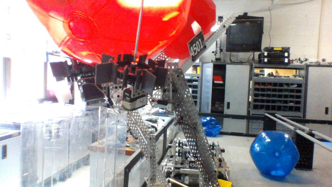

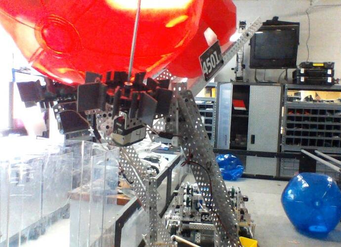

How do you build a magic intake. One team at my club tried it with their 4-bar, but could not figure it out.
What we have found is the height of the intake must be at the top 1/3 of the bucky ball. That way when driving around the bucky can be on the outside of the intake and the ball will still be sucked in by the intake although not directly in front… like it’s magic
Heres how you build a magic intake
Step one: do it yourself.
There is no way to build one while most had the five or four sets of two flaps beside each other I had one that.
I can get better pic when it comes back in the mail
[ATTACH]8343[/ATTACH]
