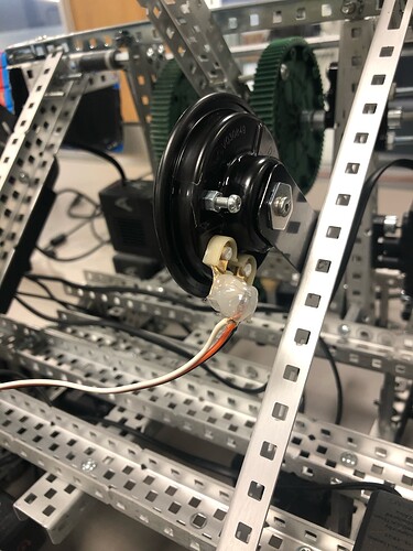

Made a horn addon for our robot

The parts I used were the wire that connects to the letter ports on the brain, this solid state relay from digikey, and this 6v snail horn on Amazon.

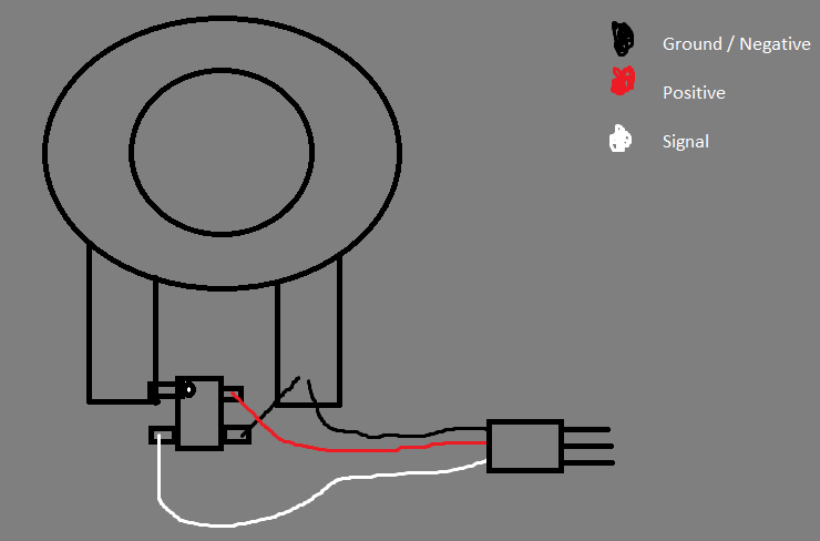

Here’s a diagram of how I wired it all:
In the code you just got to set the whatever port you connect it to high or low

As long as the brain can power it, so I’d stick with any 6 volt horn you can find
