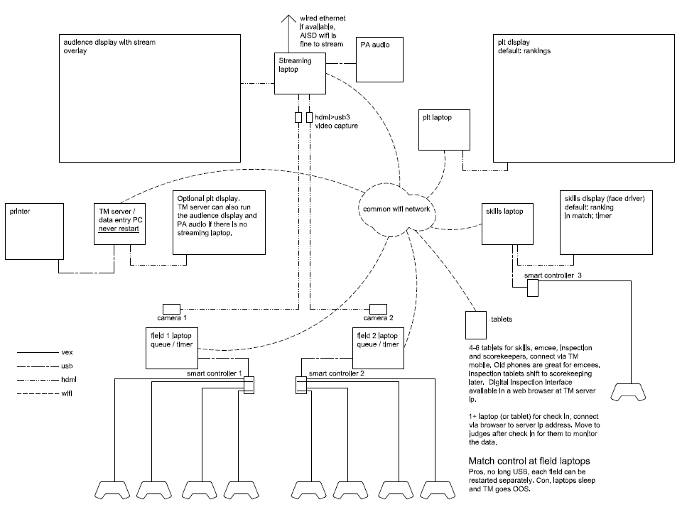

Here is a wiring diagram for a basic tournament with streaming.
TM-hardware-medium.pdf (162.9 KB)
TM-hardware-setup-2025.pdf (105.2 KB)
A checklist for setting up the server and field control as shown in the diagram above, with some troubleshooting notes.

Laptops have the advantage of a display that can be turned opposite of a second monitor so refs and audience both see it. I have access to a cart full of laptops, so it costs me more to take the cheaper option of mini computer.
I do think a Pi would be more stable at the task, since my district’s software will not allow you to force laptops to stay awake – I have issues with sleeping laptops losing contact with TM.
