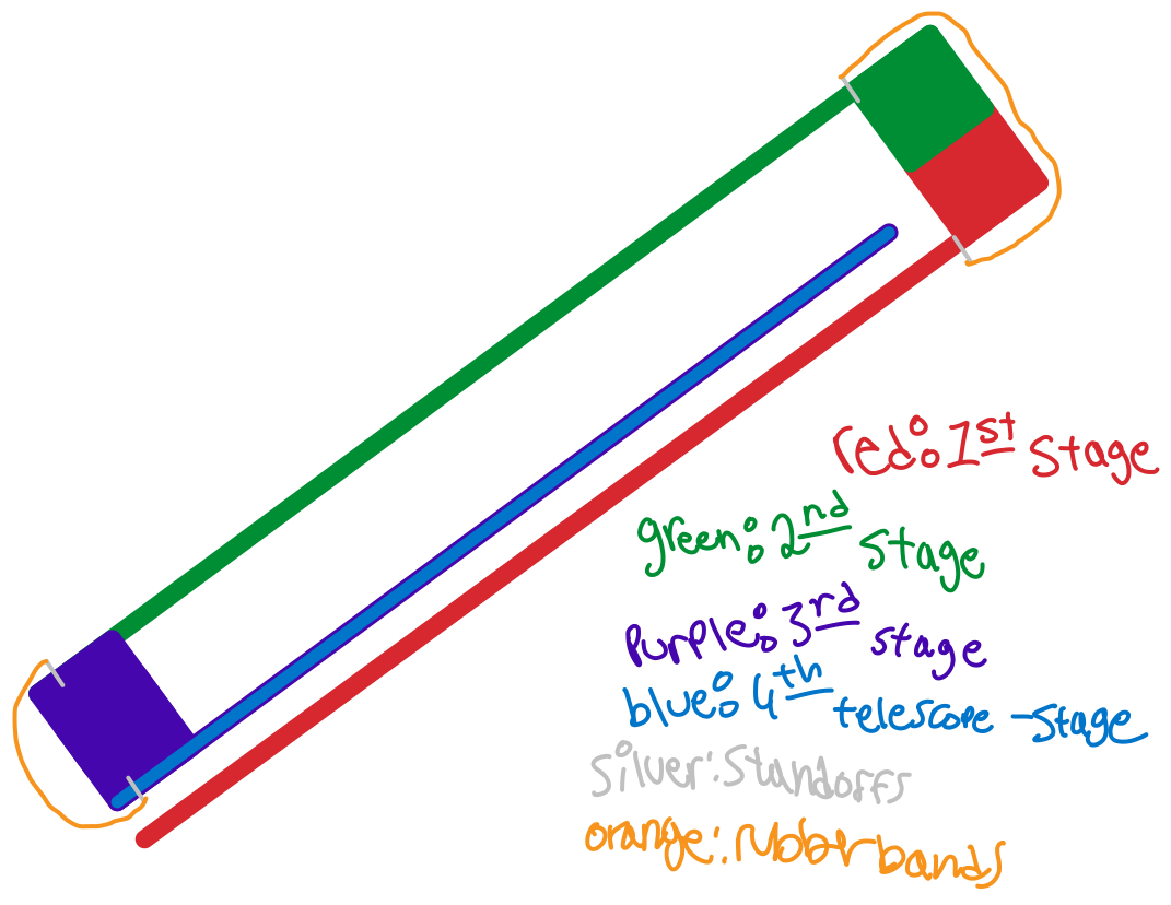

Here is what my team uses. The third stage fits in between the second and first stages. The telescope fits inside the third stage (we use a 5 wide C-channel and we put the telescope inside it)

How are you achieving the telescopic tray, without having it get caught on the 3rd tray?

It’s on the inside of the C-channel. Since it is a 5 wide C-channel, we have a smaller C-channel inside of it. We use standoffs and spacers to keep the other C-channel from moving up and down inside the larger C-channel, and they allow the telescope to slide
