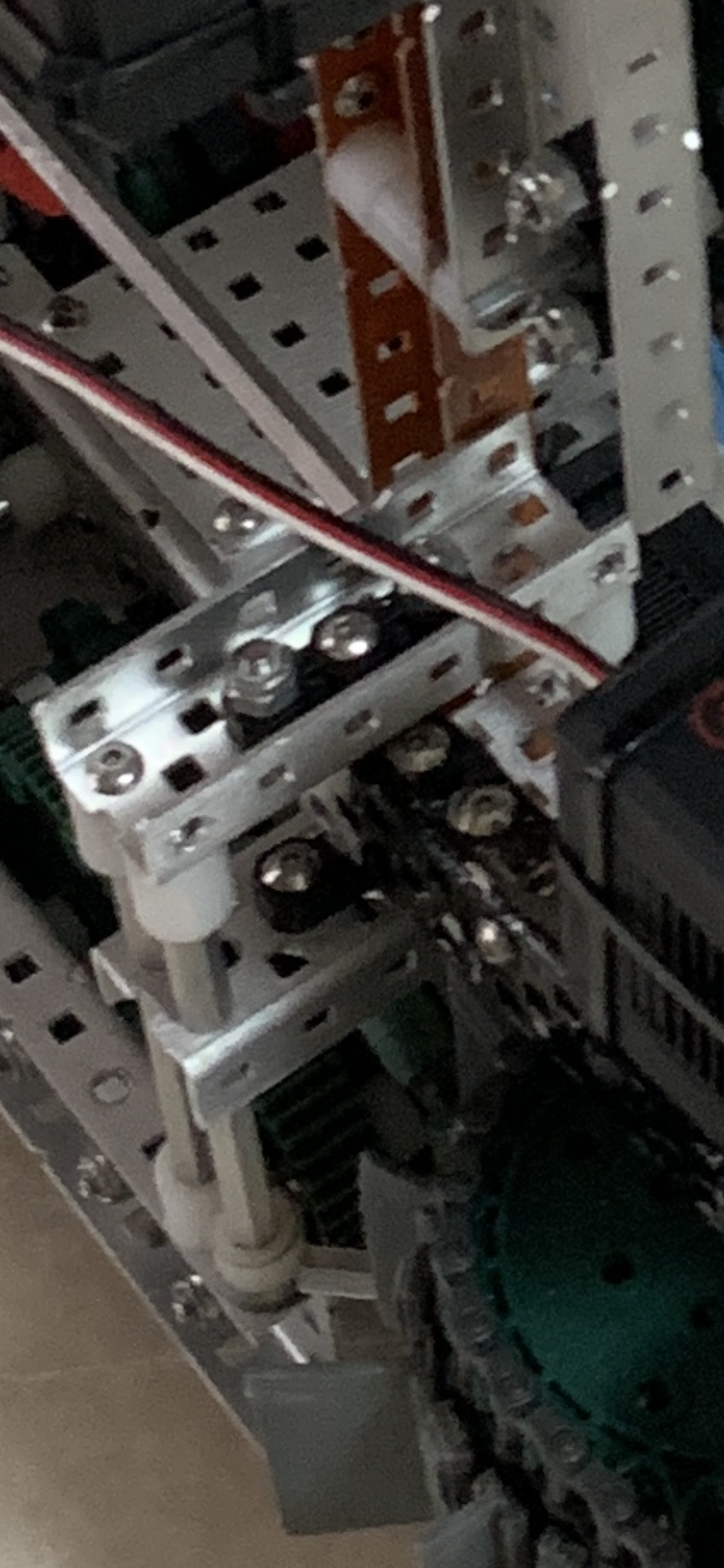

So my I was wondering how different teams are doing there intakes for this years game… My team is struggling to figure out mounting. If you could post a picture or explain your design here that would be great!
Ours is similar to the bot we had last year: 2 larger flap wheels at the front that pull a ball out of the goals, then we have 2 mini wheels that push the balls far enough into the bot so the belt can grab onto the balls and score them.
For mounting we have a c-channel that is the backbone of the intakes mounted with 1 screw to the base in order to adjust its angle with additional stand offs/ c-channel coming from either direction to lock it in.
We wanted our intakes to pivot for the middle goal so we essentially went for a “door hinge” design where the intake c channel runs through an axle between 2 other c channels. The actual intakes are a flap roller upfront and 3.25 traction wheels at the back, pointing straight out.

Our team sticked with mounting the roller with a platform raised by standoffs along with a screw joint. It’s a pretty solid choice.
We also iterated quite a lot on the roller, first starting with 2 separate rollers with 24t sprockets on the back and 2.75” omnis in the front. Then we switched the front to 24t sprockets as well. After that we tried out normal TT tread intake; and lastly were now using 600rpm rollers with 2 4” omni wheels.
My final verdict is actually that roller design really doesn’t matter that much. The goal tolerance probably a bigger factor as it can range from 6.1” to 6.6” (the ball is 6.3” in comparison). This means that the goal can be either so tight that it will be hard to remove balls even with your hand, or have zero resistance stoping the ball.
I was at first going to do a custom plastic intake but realized that is unnecessary and later choose to do a tower takeover/China style intake on a screw joint to pivot when going around the goal. And when I figured out that the plastic intakes weren’t neassary I was sad because I spent a lot of time in cad designing them.
