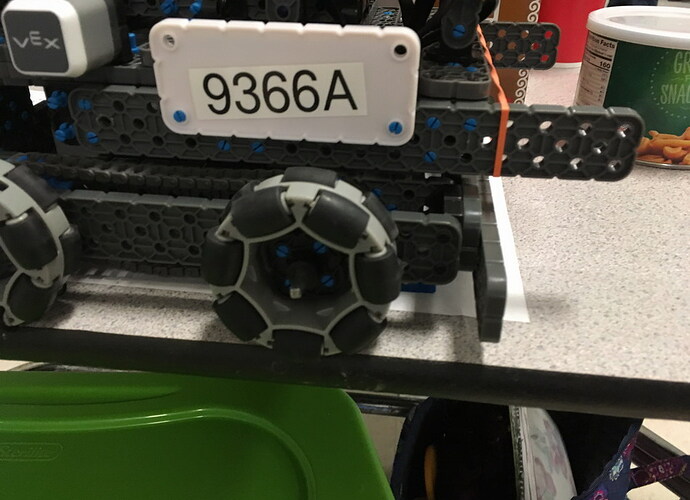

The standard Clawbot and Stretch are tricky to get to run straight. Some of this is to do with the outside edge of the wheel axles being unsupported. and so the wheels can add a surprising amount of steering. Supporting the wheel axle on the outside edge can really aid stability.

Saw this at competition. Looked like a really good idea to prevent wheel camber problems.
