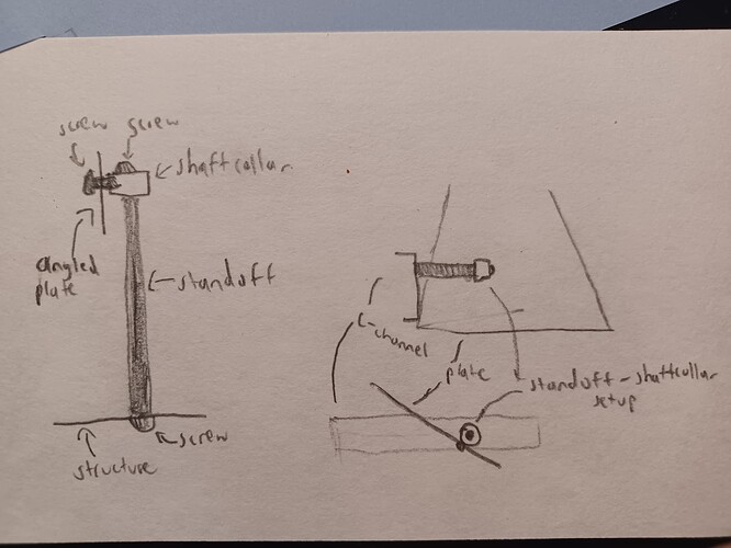

Also I need a nearly 30 degree platform where triball whill climb in, how can i put it
We can find the hole spacing with a tangent function (correction to my earlier post):
This shows the hole spacing to grt a 30 degree angle. (Incline your plate/metal piece 7 holes long and 4 holes high)
As for mounting, you can use a shaft collar-standoff setup
Great idea, thanks for your help
