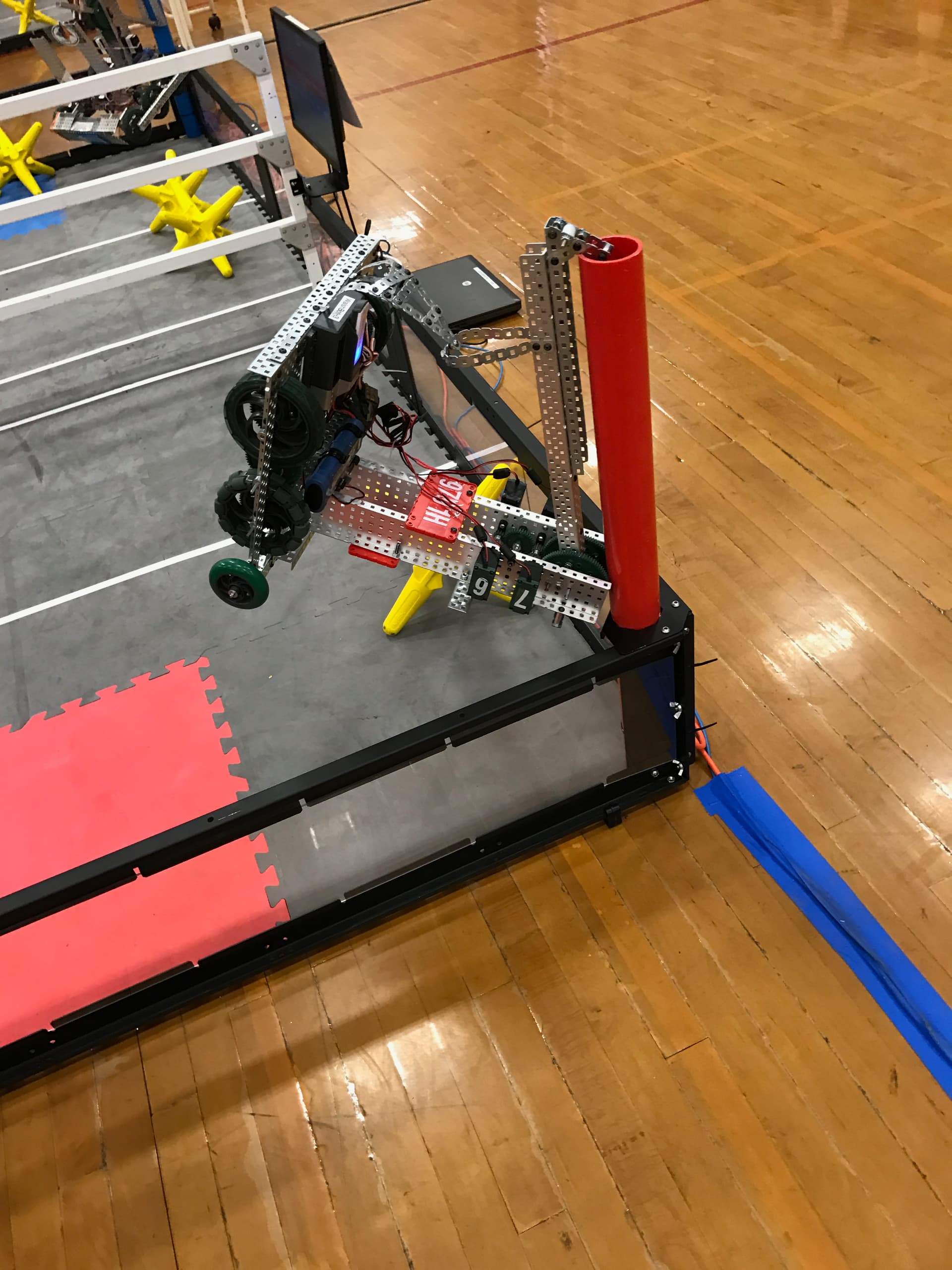

You can look here for knowledge base articles for V5 - if you look under Mechanical tab there is a whole section on mechanisms. Weigh each option based on your experience and suitability for the problem you are trying to solve.
Do note, what ever solution you pick for your robot, you will need to remember that the motors are turned to coast at end of match , meaning if you require the motor alone to hold your robot in the air, it is more than likely going to fall to the ground.
Watch competition videos and see how others have approached the problem.
It is ok if your robot does not lift at end of match if you are not yet experienced at building mechanisms. Best to focus on a couple of things you do well than over extend and have a robot that performs poorly.

I do wish to point out that in Star Struck there was a hanging element end of match, one of our team figured out how to do a passive lock that worked for that game. However, in that game the could latch onto upper tube opening, in Over Under this is not an option.
