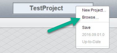

To find where it is being saved, go to the drop down next to the Project Name and click ‘Browse’
Then you’ll see where it is putting the .Vex files (green arrow is pointing to the directory). You can change it by clicking the change button and it will start to save them in a different place.
It’s not a .vex file for IQ Modkit, it has a different extension, MK4V
As I mentioned earlier and as @gbr said, click browse then click change to change the folder location to something more accessible, I just have a Modkit folder in Documents and save stuff there.
