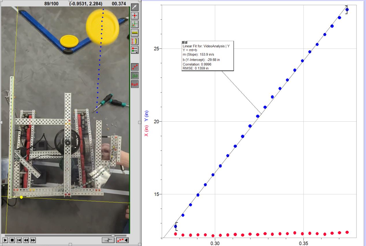

The discs initial velocity will vary based on the amount of compression. A way to figure it out is to establish a background reference (for example a 1 inch square grid) and place it behind your flywheel. Then record your disc being fired, find how much it moved in 1 frame and use your frames per second to calculate speed.
To expand on EcstaticPilot’s advice…
Use the fastest frame rate available to you. I assume you will probably record with a cell phone and depending on the settings, your framerate can vary. Standard video could be 24 fps, but is probably 30. Recording in 4K will probably use 60 fps. You will hopefully have a slow motion setting that can record at 1/4 speed (120 fps) or even 1/8 speed (240 fps). Look through the settings and know the frame rate beforehand.
Also, I’d measure the distance the disk moved for more than 1 frame and divide by the total time for those frames. This would reduce measurement error and the disk probably isn’t slowing down much in the first few frames. In a pinch, you could estimate the distance using the 1/2 inch hole size of VEX structure, but a motion grid would be best.
Even if you don’t want to measure the speed, looking at a slow motion video of the flywheel can help you troubleshoot. Here is a quick clip one of my teams took. It helped then tweak the disk being fed into the flywheel, but could easily give them the launch speed. (it was shot at 240 fps, but is now a 10 fps animated gif.)

You might also consider using a chronograph. There are different model’s but one that uses a large detectable area to sense the disc could work. A chronograph will give you the fps (feet per second) or mps (meters per second). You could also use a slow motion video, calculating how many frames it takes the disc to go one foot, then converting the frames to seconds, giving you fps (mark rober has a great video on this, but I can’t access youtube as I am on school wifi.)
I threw the above video into Vernier’s Logger Pro for a quick video analysis (many other software options are out there)…
This one looks like it launches at about 154 in/s (just under 13 ft/s).

Also, the flywheel in the clip was 5:1 on a blue 600 rpm motor… so theoretically 3000 rpm like in turbodog’s example. I don’t know what the actual rpm was, but it is certainly lower than the theoretical 3000. The point is that it will never get up to that theoretical speed and it will slow down some when engaged. In my example, launch speed was about half of theoretical… 13 ft/s vs. 26 ft/s

Just to update… the team in the video clip added a ball bearing, added a single flywheel weight, and tweaked a few other things. Launch speed has increased from 13 ft/s to 19 ft/s. Now they are looking to improve their channel design for a touch more efficiency.
