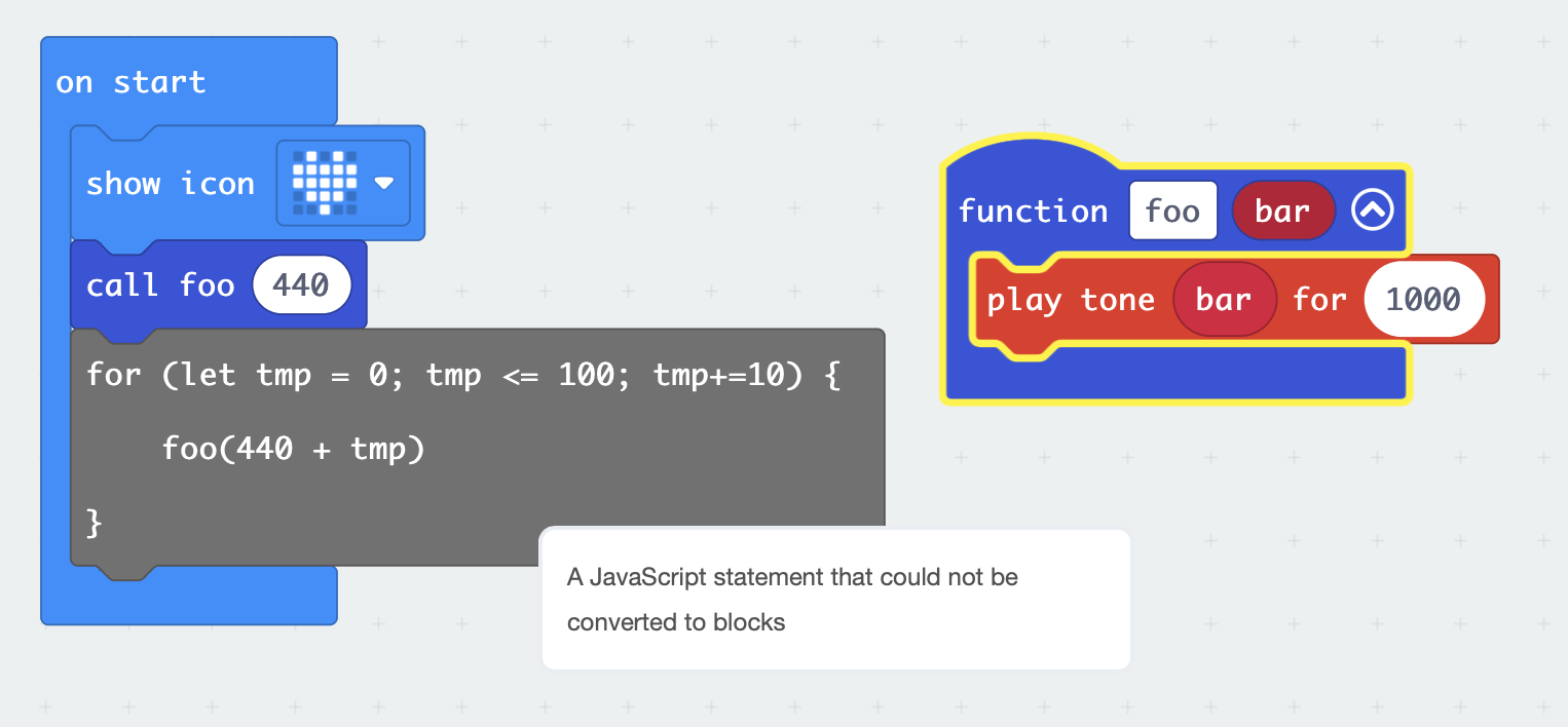

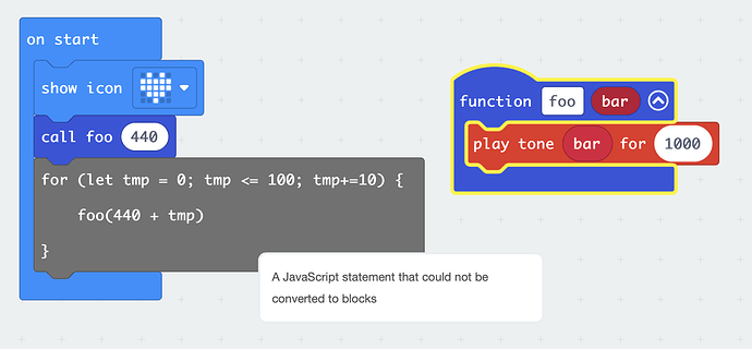

One example of a scratch-style programming environment that does text-to-blocks conversion (albeit from Javascript rather than C++) is Microsoft’s MakeCode:
But it’s not magic, if your JS code is even slightly different from what a block would generate, it will put your JS in one big grey block:

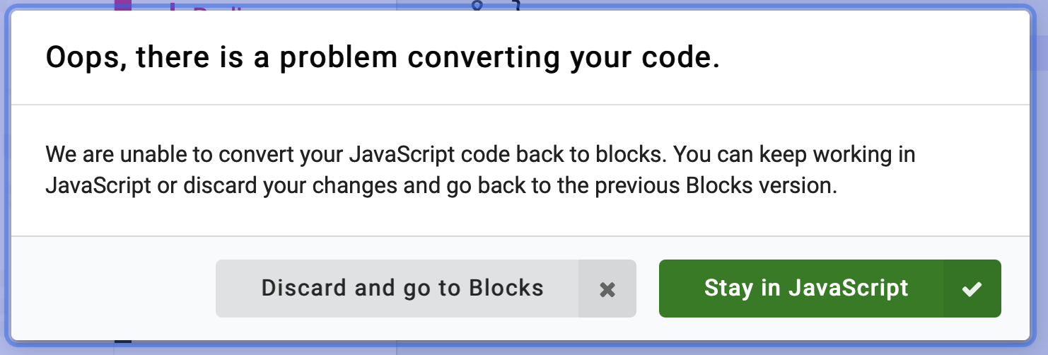

and there are some cases (mostly errors in your JS) when it just gives up altogether:
Screen Shot 2021-06-04 at 10.39.06 AM
but still, a cool and useful feature!
