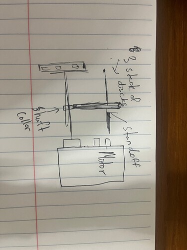

This is our idea for our indexer. Basically because the stand-off pushed the disk from the back into the flywheel. It’s basic and it works as long as the stand-off is just the right height. In the middle of our polycarb resting area we had a slit for the stand-off to go through.
We didn’t have much space so this was quite compact and it also allowed us to rachet it so when ur moved the other way it would launch endgame.
I was not able to find any images of the actual thing.
