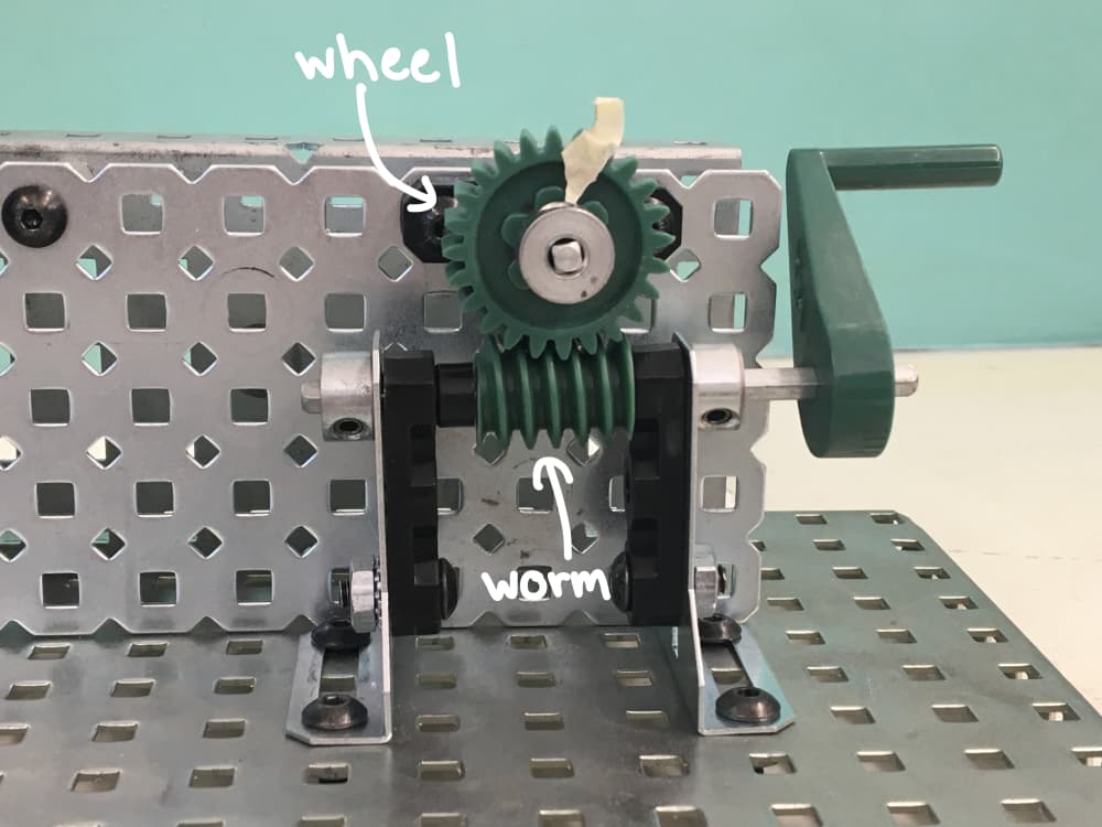

How do I lock my arm motor when climbing?
Usually the motors just lower the bot when the driving stops. Is there a way to lock the arm motor when the comp driver control period stops, to prevent the bot from losing its climb?

When a robot is disabled at the end of a match, the motors are set to coast. In order to prevent the bot from losing a climb, you’d have to come up with a locking mechanism.

setting the motor to hold wouldn’t fix the robot dropping when it is disabled, as disabling sets all motors to coast automatically.
The simplest way to lock your mechanism when electrical power is no longer available (to hold motors) is, probably, to have some custom hook or ratchet that engages at the end of the climb. This works well if you have a single final destination and don’t need to move after that any more.
More complex, but reversible mechanisms may be based on some sort of pneumatics to engage and disengage external brake.
However, there are ways to achieve similar reversible functionality that doesn’t rely on active pneumatics or motor power purely by mechanical means.
One of them is to use worm gear, which cannot be backdriven. The disadvantage is that you need to go through very high speed gear ratio first, which leads to high friction losses, and VEX worm gear and wheel are not as strong as the regular high strength gears and are quite fragile.
