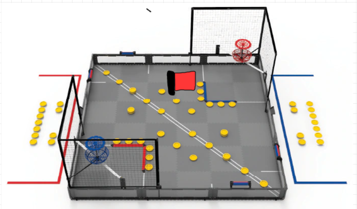

So my team and I plan on making a bot that intakes 3 discs, then gets into range and then uses Odometry or some tracking system to basically turn itself around and align itself with the goal. So it would look like, once the bot get’s within range of the goal, the driver then has to hit one button to auto-align/point the bot to the goal (by simply rotating in place), even if the bot is turned completely around. Then hit another button to launch each disc through the flywheel.
My question is what type of sensors would you need to make this “tracking-system” work?
How would I program the entire thing to integrate the sensors with the motor control?
In this scenario imagine the red box is the bot, and the front of the bot is the black oval. The Driver by default lets the bot have 3 discs, and get into range.

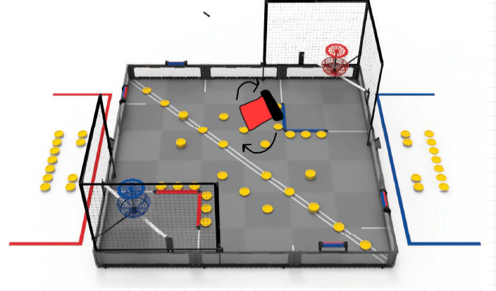

I need the tracking-system to rotate the bot in it’s place so it faces the goal, moving in no x and y position, only turning around, or rotating around in the same x and y position to face the goal. With one press of a button.

There are many different way to track the goal. 2 of the most popular way are odometry and vision sensor. Odometry uses tracking wheels to find the robots position and then you can use trigonometry to point to the goal. Vision tracking uses the vision sensor to identify the goal by it’s color and turn to face it. The easiest way to integrate it is to use PID.

Sorry for being so vague with what I wrote but I forgot to specify that the bot in-taking 3 disc’s and getting into range is all going to be done by the driver, the only thing that I want to be done by the bot (using a tracking-system) is to simply turn around in place to face the goal.
So in this senario imagine that the red box is the bot, and where the black oval is, is where the front of the bot is. This bot, already has 3 discs loaded up by the driver, and it is range by the driver.
I need the tracking-system to just turn the bot around to point at the goal, and turn the bot around in place. So the bot’s not moving in any x or y direction it rotates itself in the same x and y position around to face the goal. In one press of a button.

Once you find your x and y coordinates using odometry, you must find the slope from the coordinates of the high goal to the coordinates of your robot, and take the inverse tangent of the slope, and convert it from radians to degrees. This is the heading your robot must face to shoot into the high goal.
This year we have 3 wheel odometery with an inertial sensor. We really do two wheels odometery with the inertial but I put 3 on the bottom just in case we wanted to find direction with wheels(maybe to avoid some gyro noise). However If you track you position and heading with odometery as well as where you started you can do some trig to find out how much you have to turn to point to the goal. If you are wondering if this is feasible for a match and if the odometery will get off, if you implement it right it won’t, or the error will be very small and will get you close and you can correct manually. Beastly in skills. I know you said you just wanted a turn to shoot, but it’s not to hard to do a velocity controller with a function of the distance to get it to lob into the goal if you have a flywheel. If you got any questions on the math/coding/track wheels I can help :+1:
