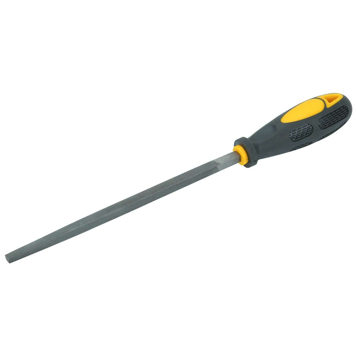

One other thing that I have seen done is to take a square file and slowly widen the square hole on the c channel. It isn’t very efficient, it’s hard, and it takes forever, but it gets the job done.
Something like this, but a little smaller should work.
Once again, this is not the best solution by a long shot, but if someone doesn’t have access to a broach, this is an alternative that I’ve seen work.
