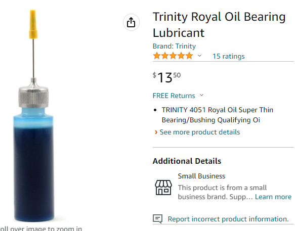

Is there any particular reason to remove the grease from the ball bearings? I thought the goal of it was to reduce friction. If you do remove it, should you replace it with your own oil/grease?
Lubrication selection is a complex issue. It depends on temp, bearing load, desired lifespan of the bearing, need for water resistance, is the lubrication for the lifetime of the bearing, and so on.
Oil/grease will make the bearing last the longest, but given that this designed lifespan is literally 100,000 hours (give or take), that’s not a real consideration here.
Running these bearings ‘dry’, without any lubrication, will give the lowest friction. If they are not run ‘dry’… then an extremely lightweight oil (and literally 1 single drop is enough) will suffice. By lightweight… I’m talking a specialty oil, something like:
The gain from removing the grease is huge. The difference between dry and a super lightweight oil is very small. I’d remove the grease and not worry about anything past that point.
