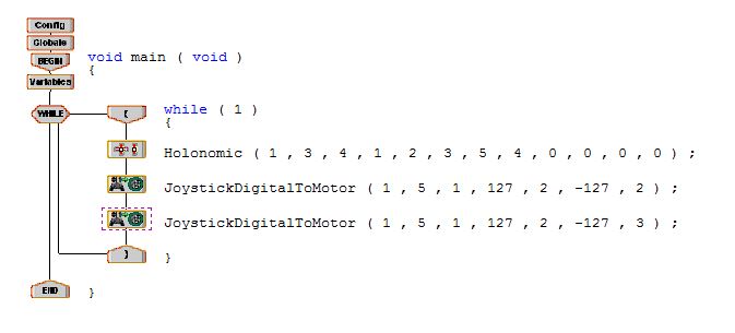

Hi I am a beginner programmer on my team so I decided to turn to easy (as u seen in my last posts) so I am puzzled now cuz I have no clue how to program the buttons on the controllers. I am gonna use the buttons for mecanum wheels u know going side by side but I have no clue how to program the buttons to do so.
Is there a way??? or can someone show me a way to use arcade drive to drive mecanum wheels? If so may I get a step by step or a sample program?? :open_mouth: that would be amazing

To program the mechanum wheels using the joysticks you’ll want to use a “Holonomic” function block in your while loop. to program the digital buttons on the front of the joystick you’ll want to use a “Joystick Digital to Motor” function block. Use multiple “Joystick Digital to Motor” commands for each additional motor you want to program. Your code should look something like this:
https://vexforum.com/attachment.php?attachmentid=8420&stc=1&d=1401822078
