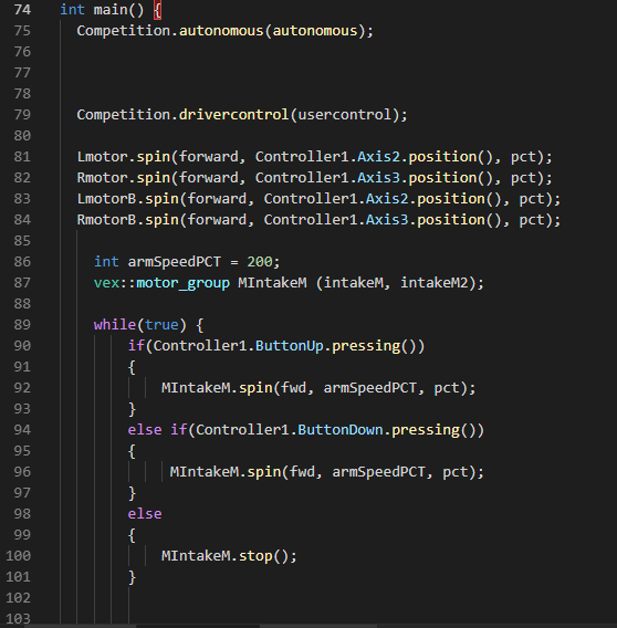

Could you upload a screenshot of the code?
pt1prog
are you using the competition template?
i suggest using that if your new.

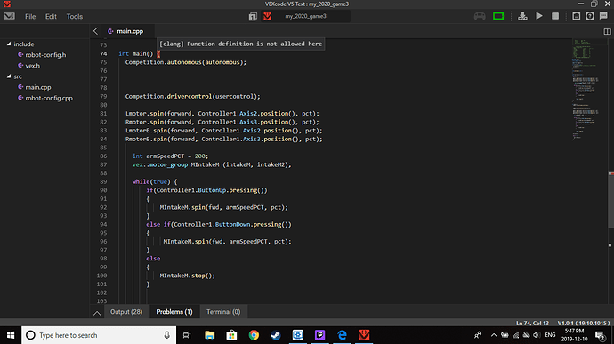

What does the error say? I’m guessing it’s probably because there’s too much/not enough curly brackets
the function is not allowed
Could you also upload a screenshot of the error?
The code for driver control should go into the driver control loop

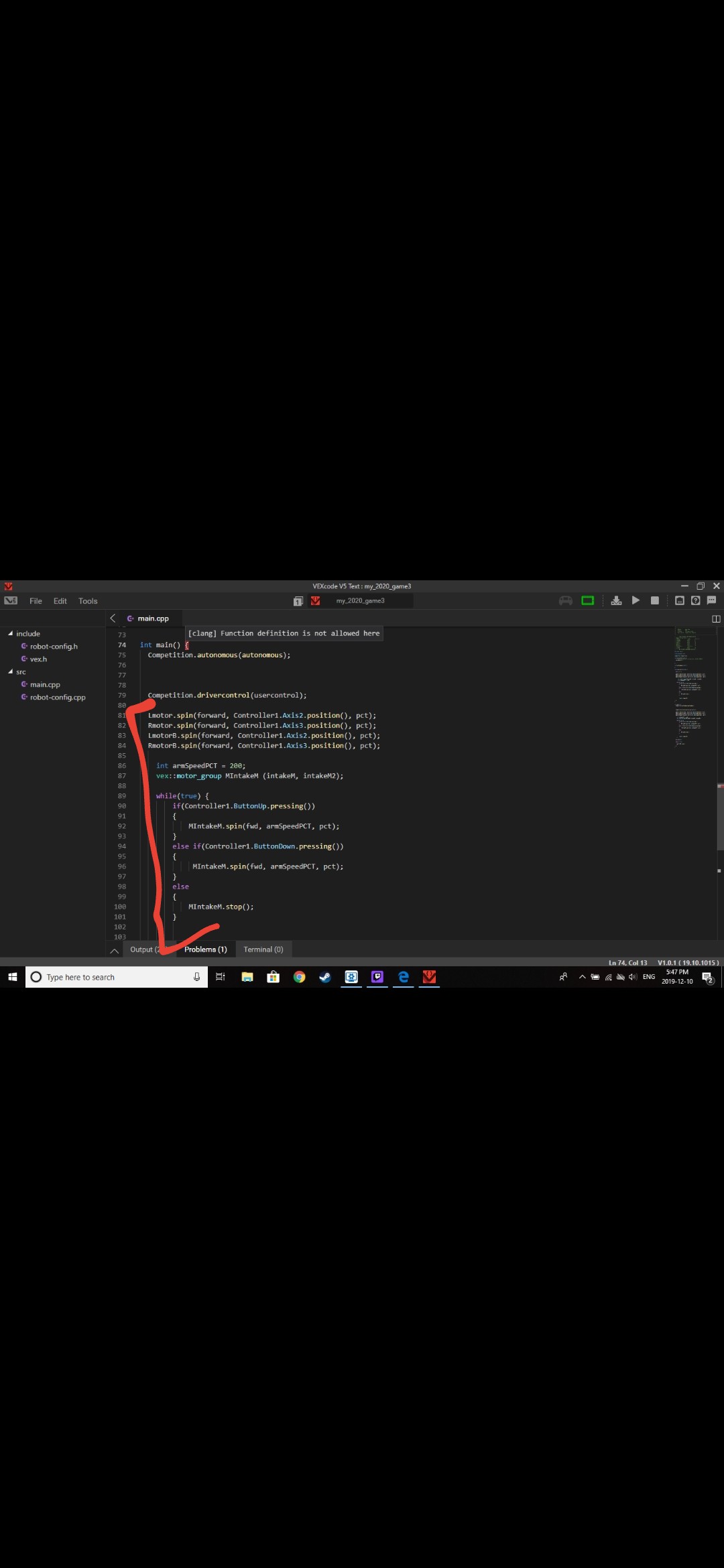

pt2prog
Screenshot_20191210-164915~2
The code in the red bracket should be in the driver control loop.
This is what should be in your int main loop if you are using competition template:

is there just lower down out of the photo
void usercontrol(void) {
