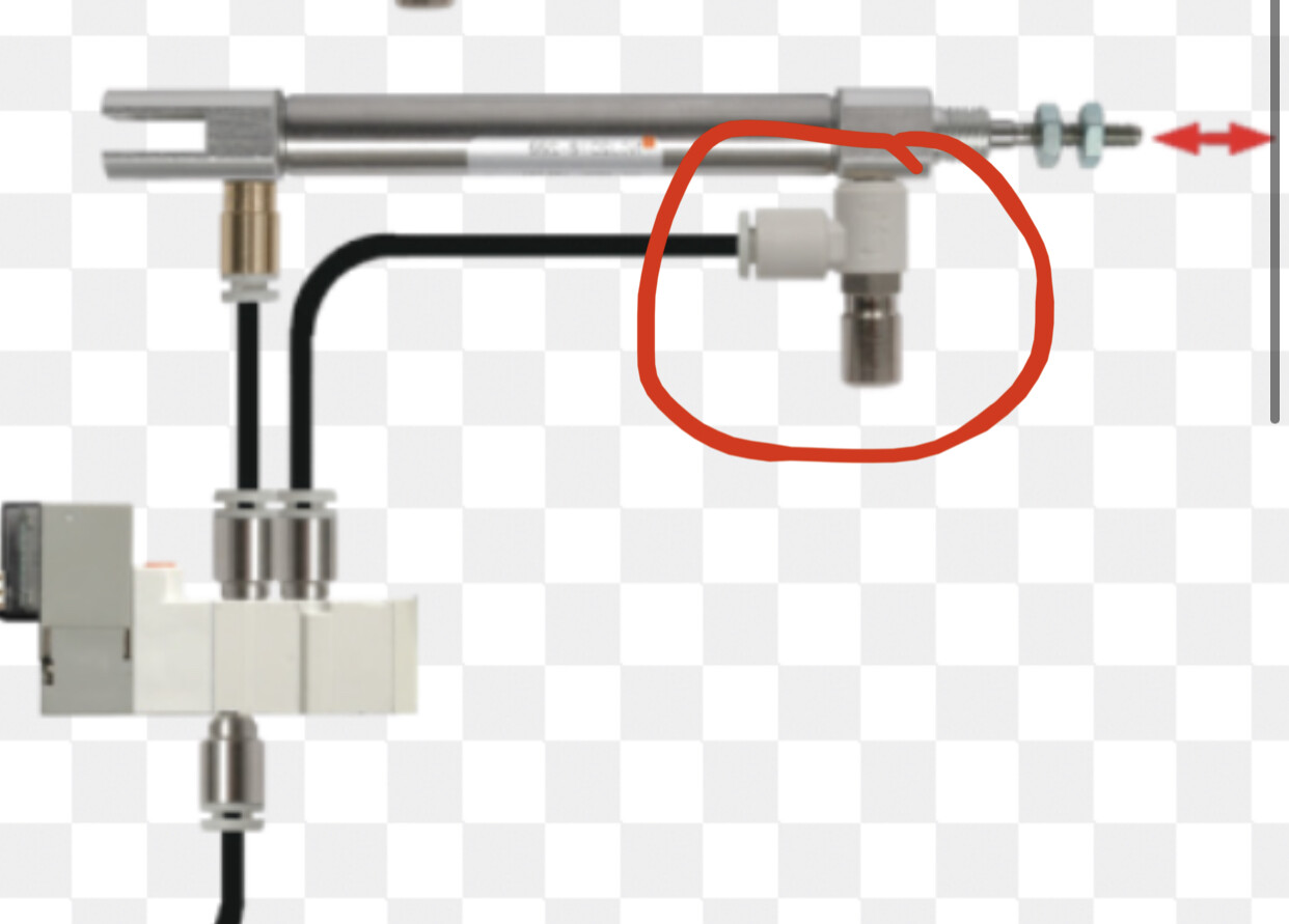

Hi, so I have two double acting pistons that I’m using for tilting up a goal post. I want them to retract at full force and speed but extend slowly.
I don’t have flow control valve so wanted to ask how I can do this without entirely losing my ability to extend or sacrificing any retraction force.
Some ideas I had were to:
  • slightly block off the exhaust valve on the solenoid
  • putting a pressure regulator on the ports on the back side of the piston
  • putting rubber bands on the piston to resist extension
I would really appreciate some help on what I should do as I haven’t used pneumatics before and don’t want to break anything by experimenting. Thank you.

use this part called a flow meter
you can adjust how fast a piston moves by tuning the position of the nut
but wouldn’t that slow my retraction as well since the air going into the piston is slowed down just as much as the exhaust
No, you can plug it into only one port. The other port will function as normal.
so if I plug in a flow meter into the extension port on a piston (the back side one), then that slows the extension by slowing the air going into the piston, but it doesn’t slow the retraction by slowing the air coming out of the piston from that port right
no.
source: me, i use it on my tilter. It works just as a I described
ok got it i’ll try to find one of those and attach them to the back side of the piston. Also, if I can’t find one, do you have any ideas for a DIY one?
