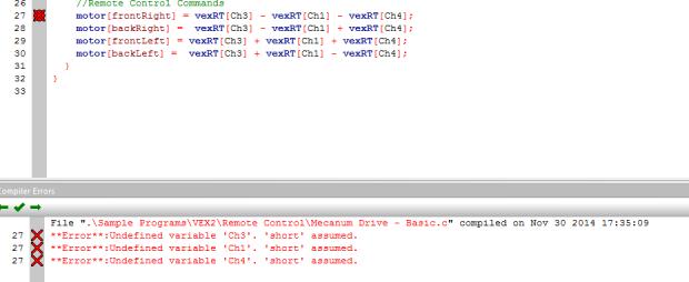

I have opened the sample program for a mecanum drive however I get this error…
What do I need to do to solve it?

Have you selected cortex as the target? (ie. not vexiq).
If your using vexIQ as the cortex target, then instead of numbers it uses letters (ex. 1=A), so you might want to check your cortex target, otherwise if your downloading to a vex cortex, you should be fine
