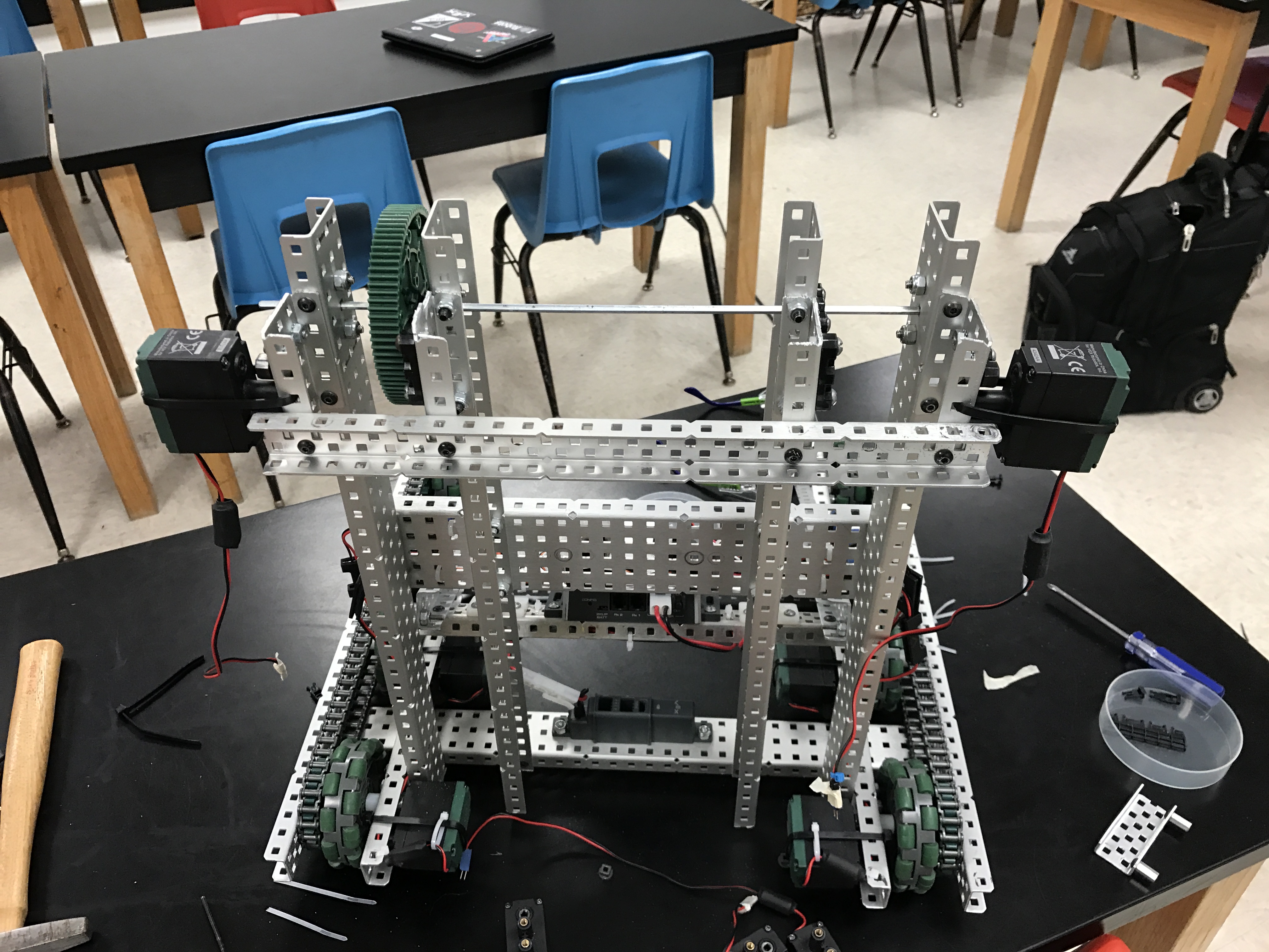

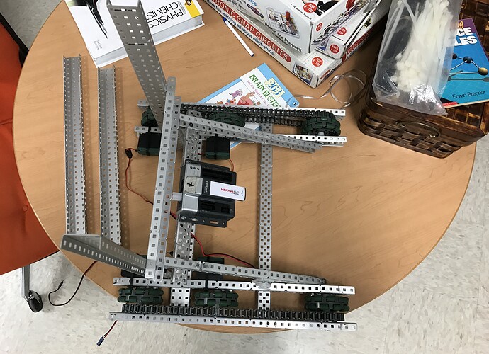

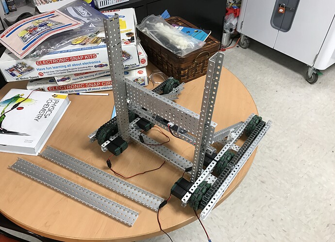

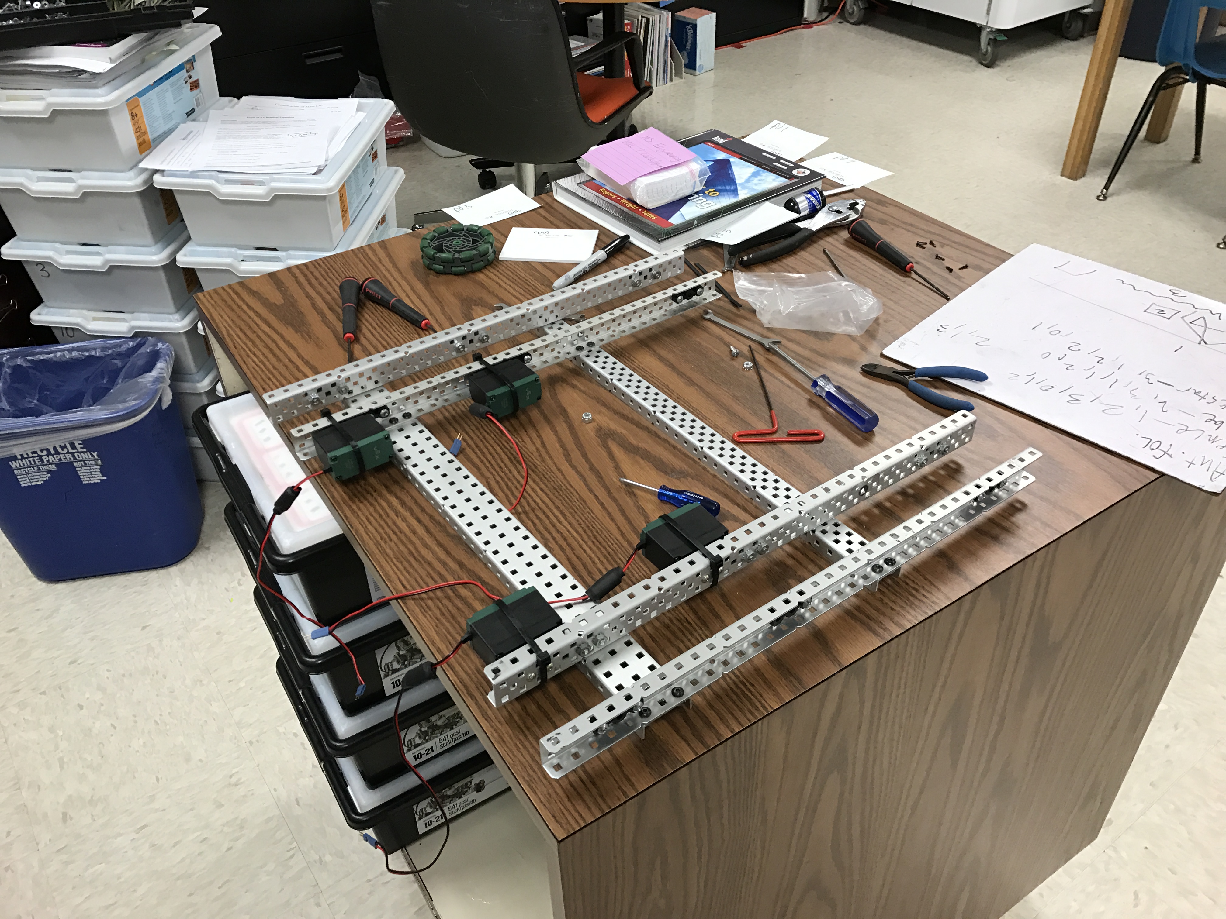

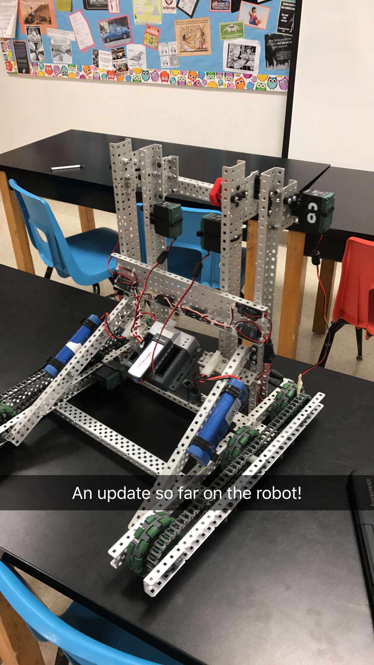

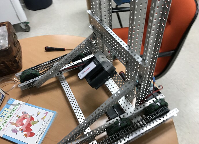

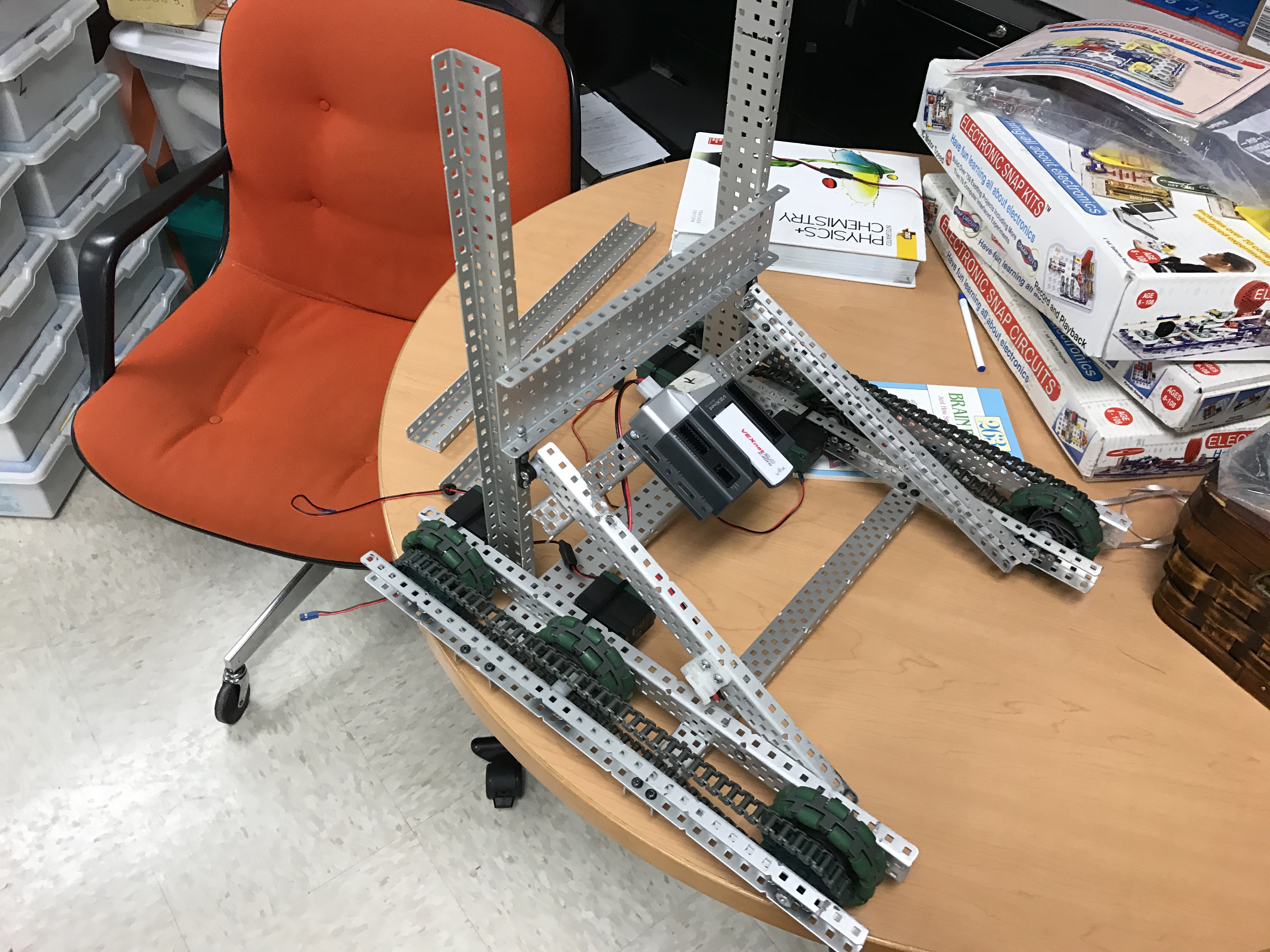

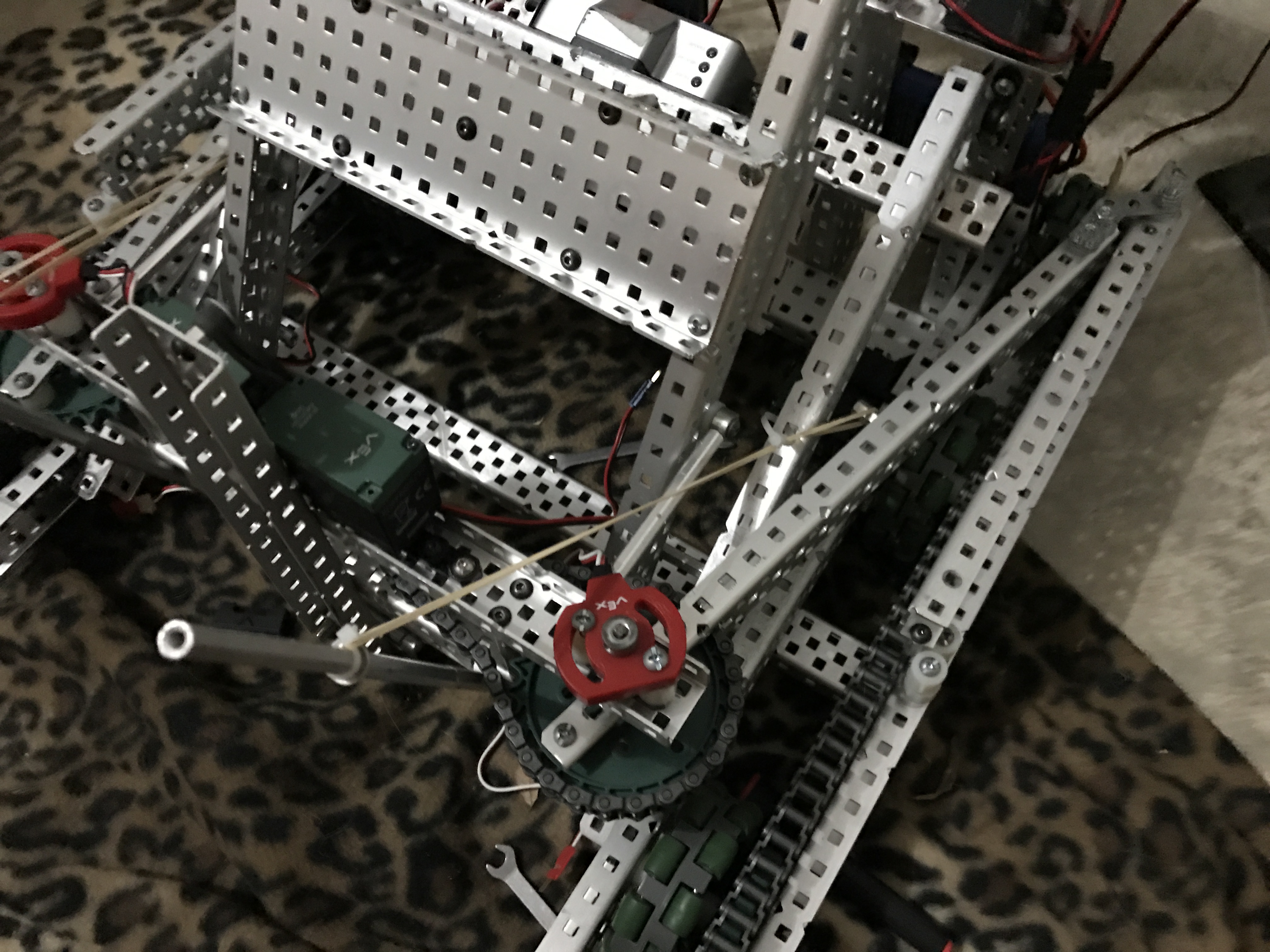

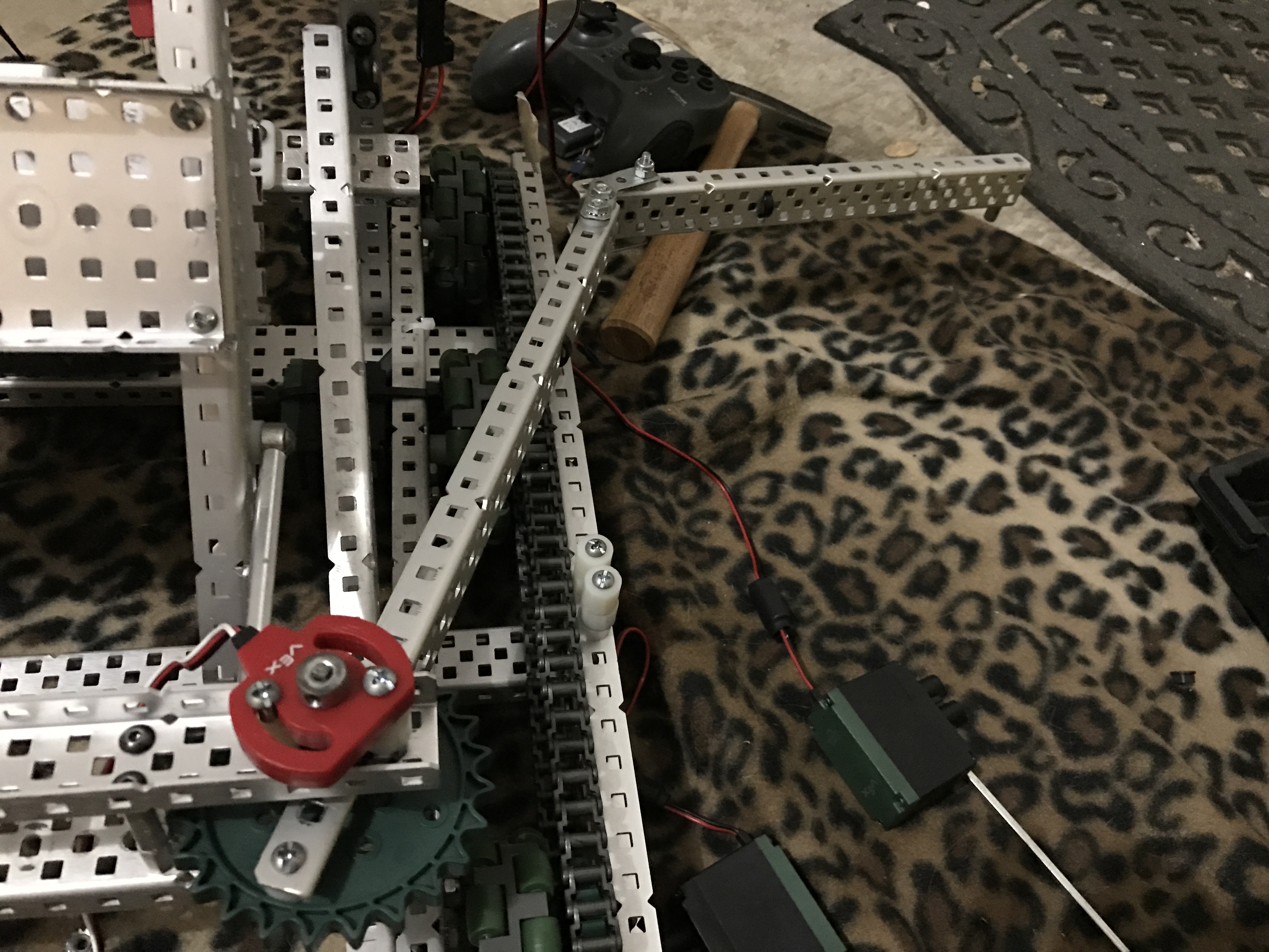

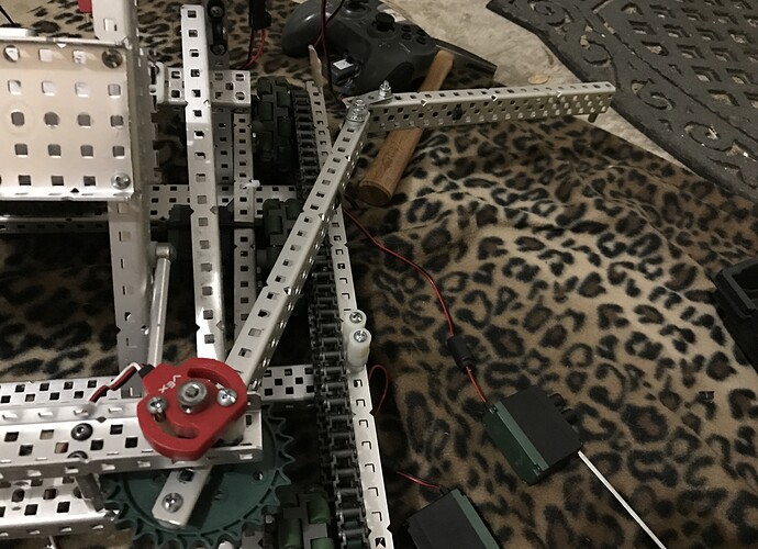

These notebooks were made on a rush though, which is why you can’t build an exact copy of the robot. Here are some pictures of Delta II Scorpion 3 in the making (Wasn’t added in the design notebook though):

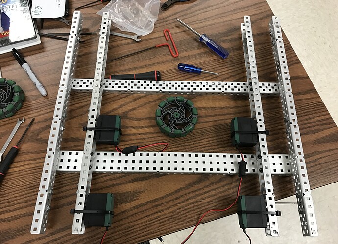

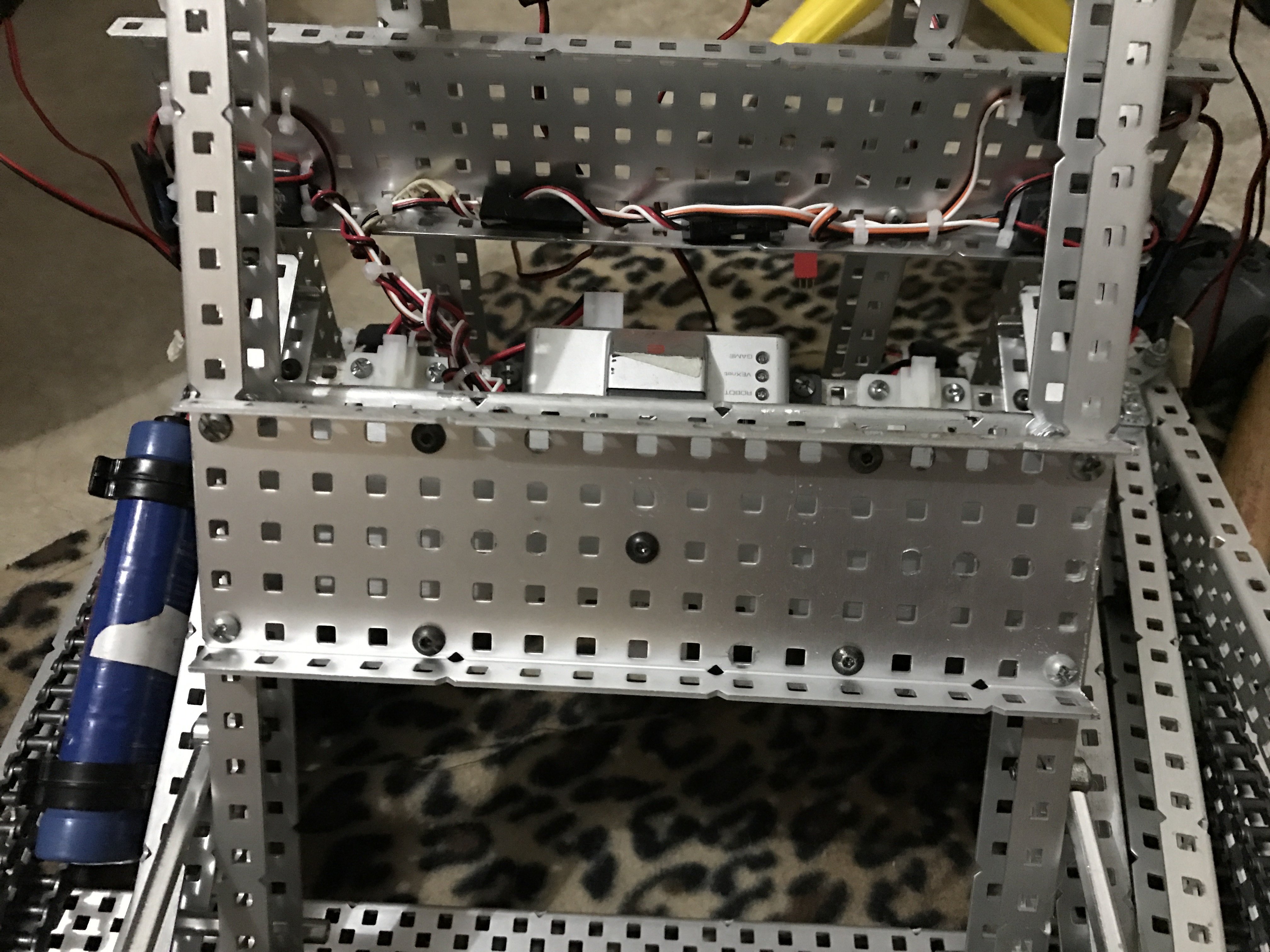

Take a look at exactly how everything is placed and how all of the pieces that correspond with eachother. When creating a drivetrain, it’s best to have at least 2 C-Channels that go across(As shown on the top pictures). Any less will mean your drive is very unstable. Triangles are useful as well when creating a lift, so attach a beam at an angle towards your “tower” or the thing that holds the lift. If you have anymore questions, I can happily answer :slight_smile:
