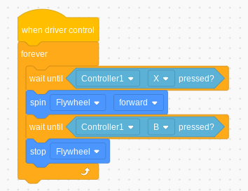

@jpearman who do I have to talk to to file a complaint that pressed in text is callback function setup and “pressed?” in blocks returns a boolean. Note I am in Pittsburgh and can find Tim and Jacob.

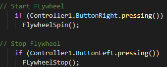

i had to make a function and call on it when i pressed the button. you can just change the controller button in the if statement.

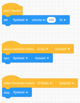

I don’t like that function, but here you go:
Code in blocks:
Generated code in code viewer:
// "when started" hat block
int whenStarted1() {
  flywheel.setVelocity(100.0, percent);
  return 0;
// "when Controller ButtonEUp pressed" hat block
void onevent_ControllerButtonEUp_pressed_0() {
  flywheel.spin(forward);
// "when Controller ButtonEDown pressed" hat block
void onevent_ControllerButtonEDown_pressed_0() {
  flywheel.stop();
int main() {
  // register event handlers
  Controller.ButtonEUp.pressed(onevent_ControllerButtonEUp_pressed_0);
  Controller.ButtonEDown.pressed(onevent_ControllerButtonEDown_pressed_0);
  wait(15, msec);
  whenStarted1();

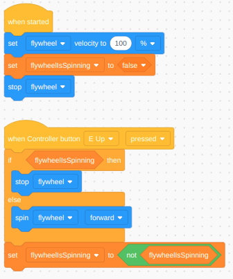

If you want one button to both start and stop it:
In code:
bool flywheelIsSpinning;
  flywheelIsSpinning = false;
  flywheel.stop();
  return 0;
  if (flywheelIsSpinning) {
    flywheel.stop();
  else {
  flywheelIsSpinning = !flywheelIsSpinning;
int main() {
  wait(15, msec);
  whenStarted1();
There’s a trick; if you forget how to do something, do the same thing in blocks and look at the code.
The biggest rule about when button pressed functions is only register them once! Don’t call Controller.ButtonEUp.pressed(function) in a loop; call it once in int main before the rest of your code.
