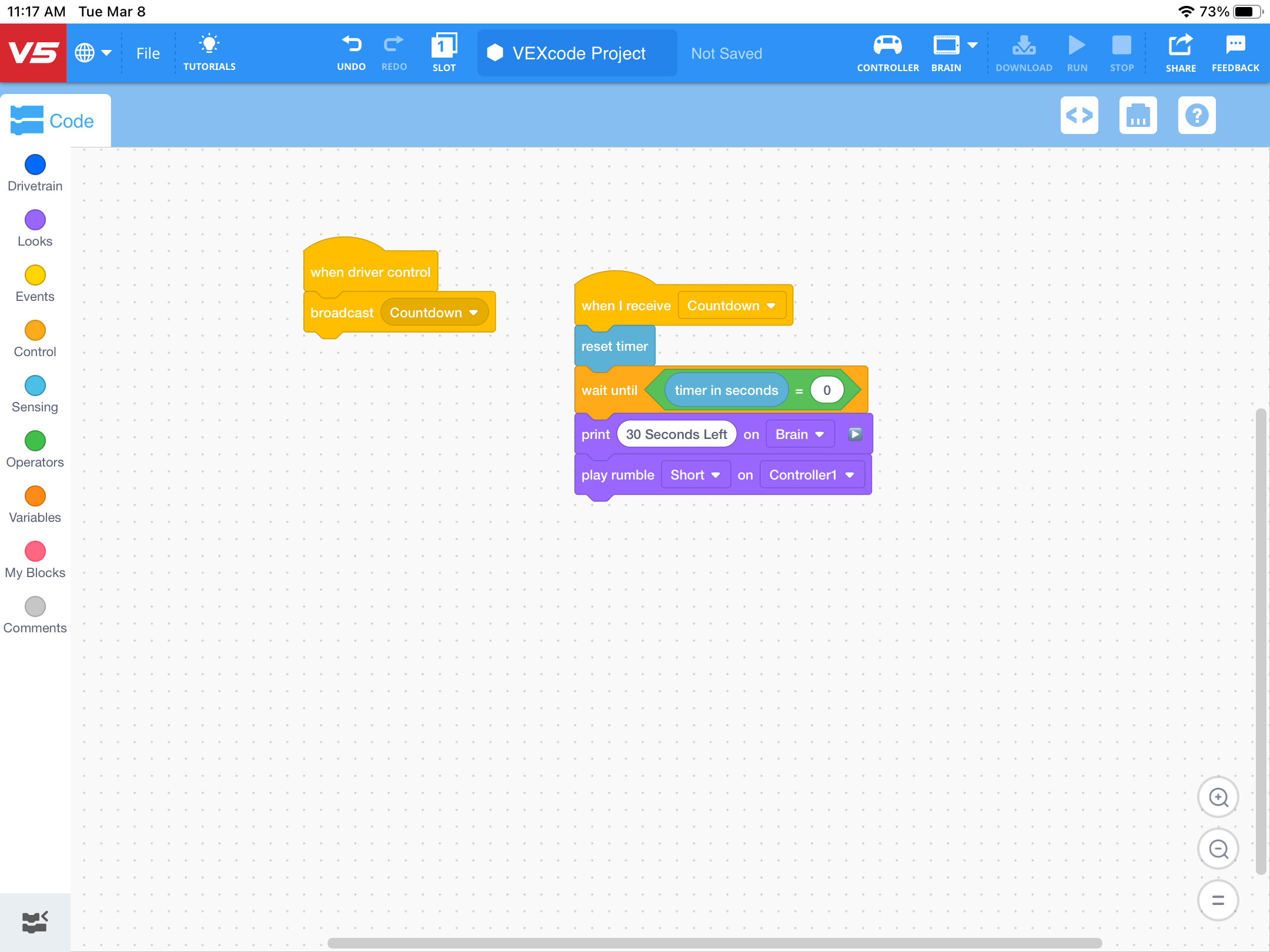

So I figured out how to use the timer but is it possible to use more than one timer at the same time? If you are wondering what I am going to use it for all I am going to do is put a warning system in so when it hits 30s it tells our driver.

is there a way that you can do it in blocks where the controller shakes at 30 seconds?
In the empty slot where it says 0 just put 30
thank you so much! this will be very helpful!
Hold on that wont work cause it counts up instead of down set the place where it says zero to 75 and that should work
